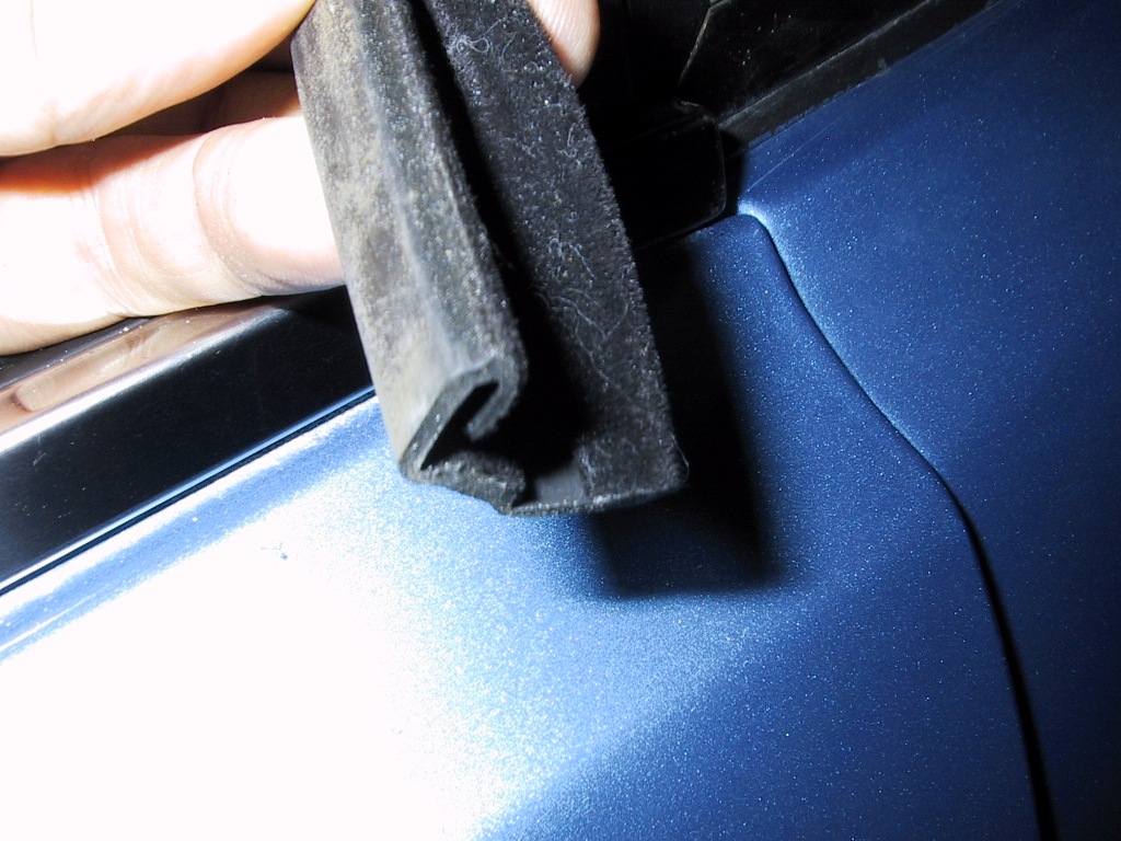

Window Channel Felt - Rubber ? They are both.
The Felt runs from just below the door panel, at the rear of the door - up around the window frame, to the front side. Below the Felt, on the rear of the door - there is a piece about 18" long that is rubber. I believe that the rubber supplies firmer grip on the window glass when it is all the way down. (just a guess)...
FWIW,
Carl B.
BTW - I thought that Bambikiller240 had removed ALL his Posts to this Site... yes deleted them before his death - were they restored from older archives - now that he is no longer here to protest?
Carl:
You've got it perfectly, but you've reversed the terms.
The FELT is a formed piece from a straight piece of felt that has had two grooves cut into it. Those grooves are where the 90° bend goes to fit it into the channel. The grooves in essence then go on the "inside" of the U that gets made when you fold the felt. It gets placed on the lower portion of the rear window guide.
The RUBBER gasket, which has a "felt" or "fuzzy" surface and may be part of the confusion , starts immediately above the lower felt, up to the corner of the window frame where you will note there has been a "notch" or 90° angle cut in the rubber leaving a small connecting piece on the "floor" of the gasket. Sometimes this piece will come with that corner already glued, but you would have to cut it if you buy the weatherstrip channel in bulk length. The rubber then continues across the top and down the angled forward portion of the channel all the way to the end.
Proper installation is critical as it's easy to NOT do something that later causes problems. Most common is to NOT glue either the "floor" or one of the "walls" of the channel and then have it interfere with the window glass, or worse not make a good seal. I have a small paint stick that has been whittled down to just fit easily inside the channel and still allow me to slide it along it's length. Then I use the 3M Weatherstrip adhesive in black and lay a medium width bead from the corner to about the middle of the frame down, then with the paint stick I spread the adhesive carefully along the bottom AND sides of the channel. This gets repeated on the other side of the corner. Then once that's done, I insert the corner of the weather stripping by carefully pinching it closed. Then, again by pinching, you then insert the weather stripping through to the end on each side.
The weatherstripping generally has enough "bounce" in it to pop back into shape once inserted and then you can (if possible) slide the actual window glass into the frame. This will spread it to the full thickness of the glass and apply pressure to the glue/rubber contact area.
The felt gasket gets applied in the same manner to the lower edge of the frame. I leave this for last since you won't know until you have the rubber gasket in place where exactly to place it.
