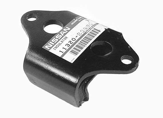

I removed the transmission 240z to clean and paint the tunnel. I'm getting ready to paint the mount and got a good look at it. The cross member is good but the mount seems to be bent/off set to the front or back depending on the way I point it. If it is supposed to be that way can someone send me to a picture of the mount in a car so I can see how it is supposed to go.
This picture help you any at all..?? Looks to me like the "Sloped" part faces to the front...so in other words...in the picture the front would be to the top right as viewed from the passenger side of transmission...

and picture of transmission mount...
Resurrecting an old thread here, but webdawg's picture is very helpful. Does anyone know the torque specs for the bolts in that illustration (both horizontal and vertical)?
I don't see mount fastener torques listed in my FSM Transmission section.
