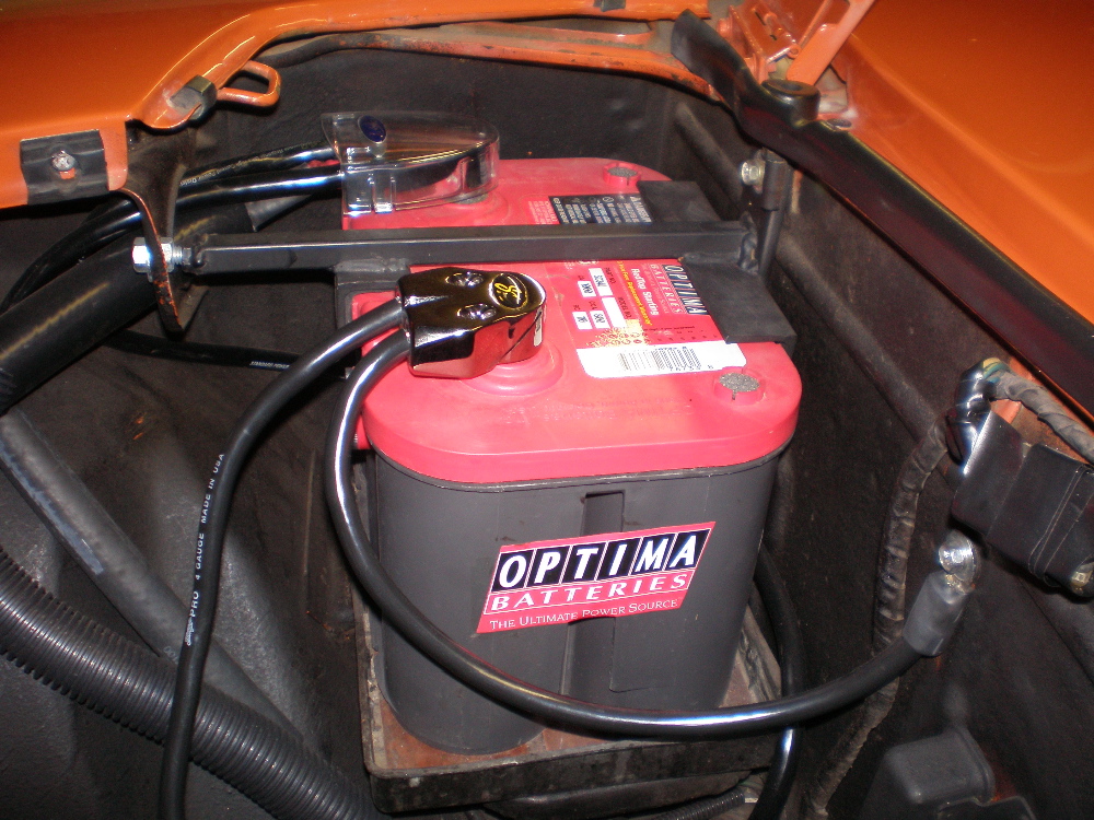

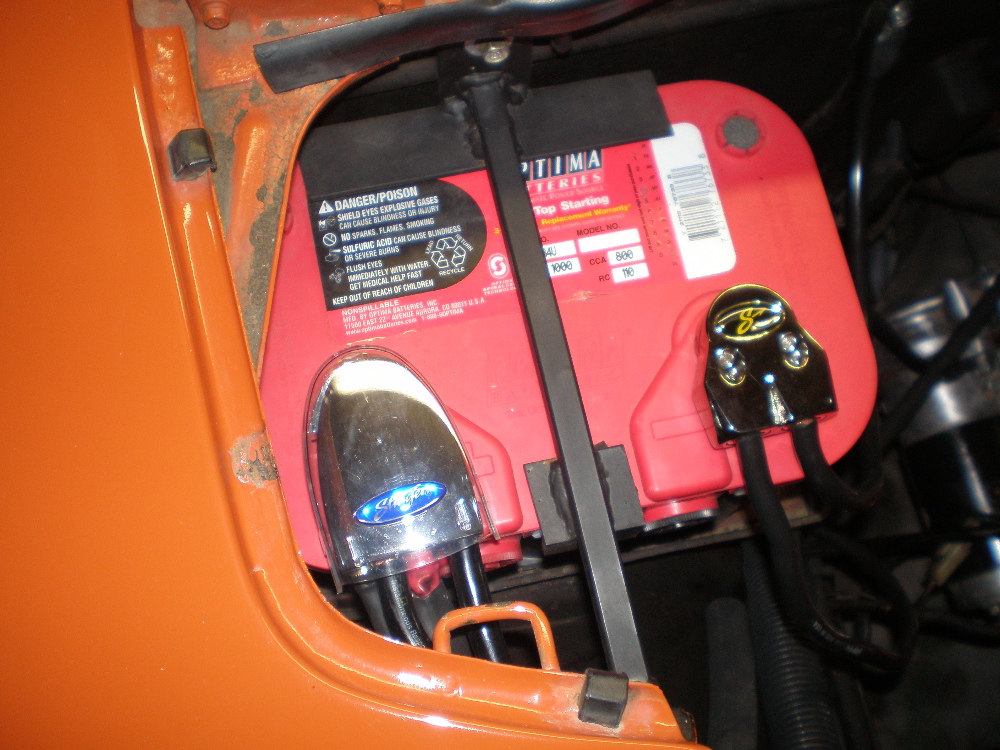

August 19, 200717 yr comment_219014 If you're looking for a great battery, consider the Optima.... Have it in all my cars; fits the Z perfect and never do I worry about any possible leaks.... Link to comment https://www.classiczcars.com/forums/topic/25234-240z-battery-size/#findComment-219014 Share on other sites More sharing options...

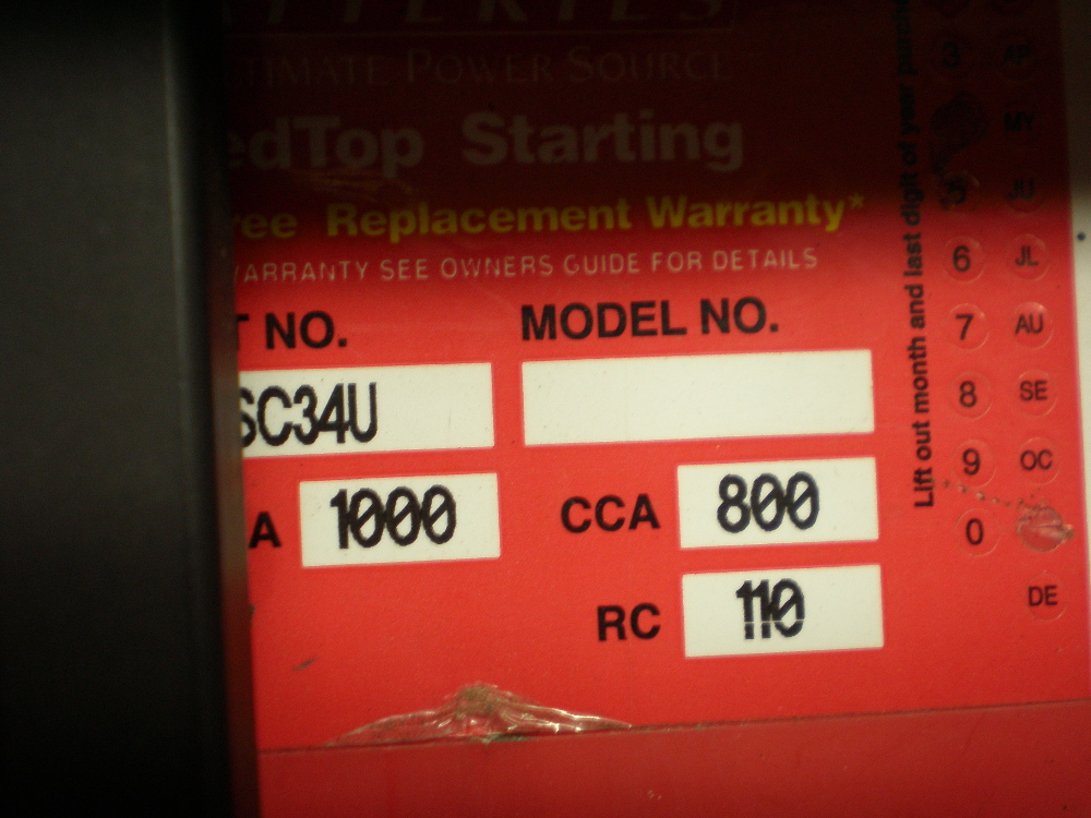

June 23, 201014 yr comment_323416 ZIII, is that a group 34 battery?DaveIf you're looking for a great battery, consider the Optima.... Have it in all my cars; fits the Z perfect and never do I worry about any possible leaks.... Link to comment https://www.classiczcars.com/forums/topic/25234-240z-battery-size/#findComment-323416 Share on other sites More sharing options...
June 23, 201014 yr comment_323421 Dave,Yes it is.... Still have the same battery in the Z, going strong.... You will have to construct a modified tie-down in order to secure it.. The picture above should give you a general idea.... Edited June 23, 201014 yr by ZIII Link to comment https://www.classiczcars.com/forums/topic/25234-240z-battery-size/#findComment-323421 Share on other sites More sharing options...
