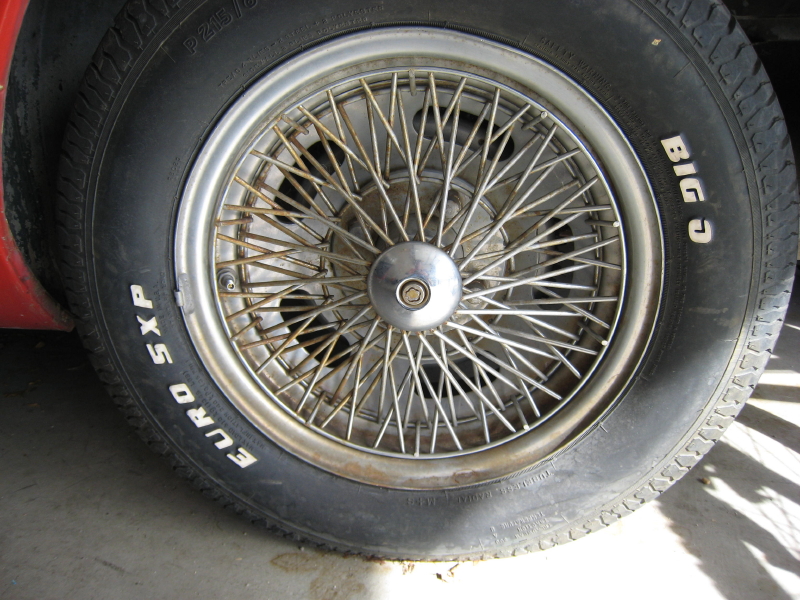

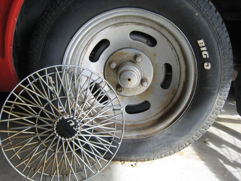

Vintage Appliance Uni-chrome slot wheels with the 'double-basket' option. If you remove the wheel from the car, the thick retaining plate has your car's bolt pattern, but the wheel itself will have several bolt patterns hidden under the retaining plate.
It will be difficult to find a chrome shop willing to re-chrome them, and if you find someone it will be expensive. And in the end you will have a wheel that is very heavy, and there are no replacement parts left for them. I personally would spend my money on a different set of wheels.
