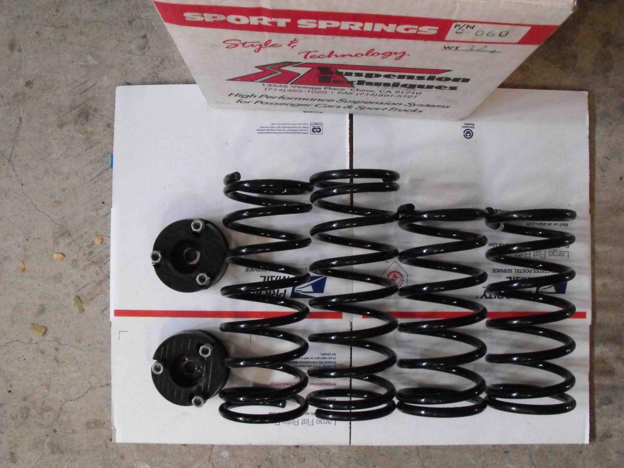

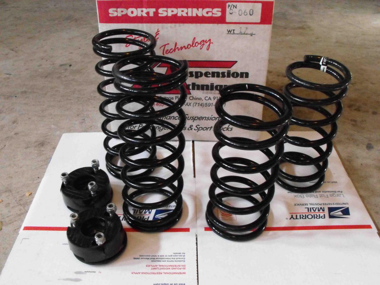

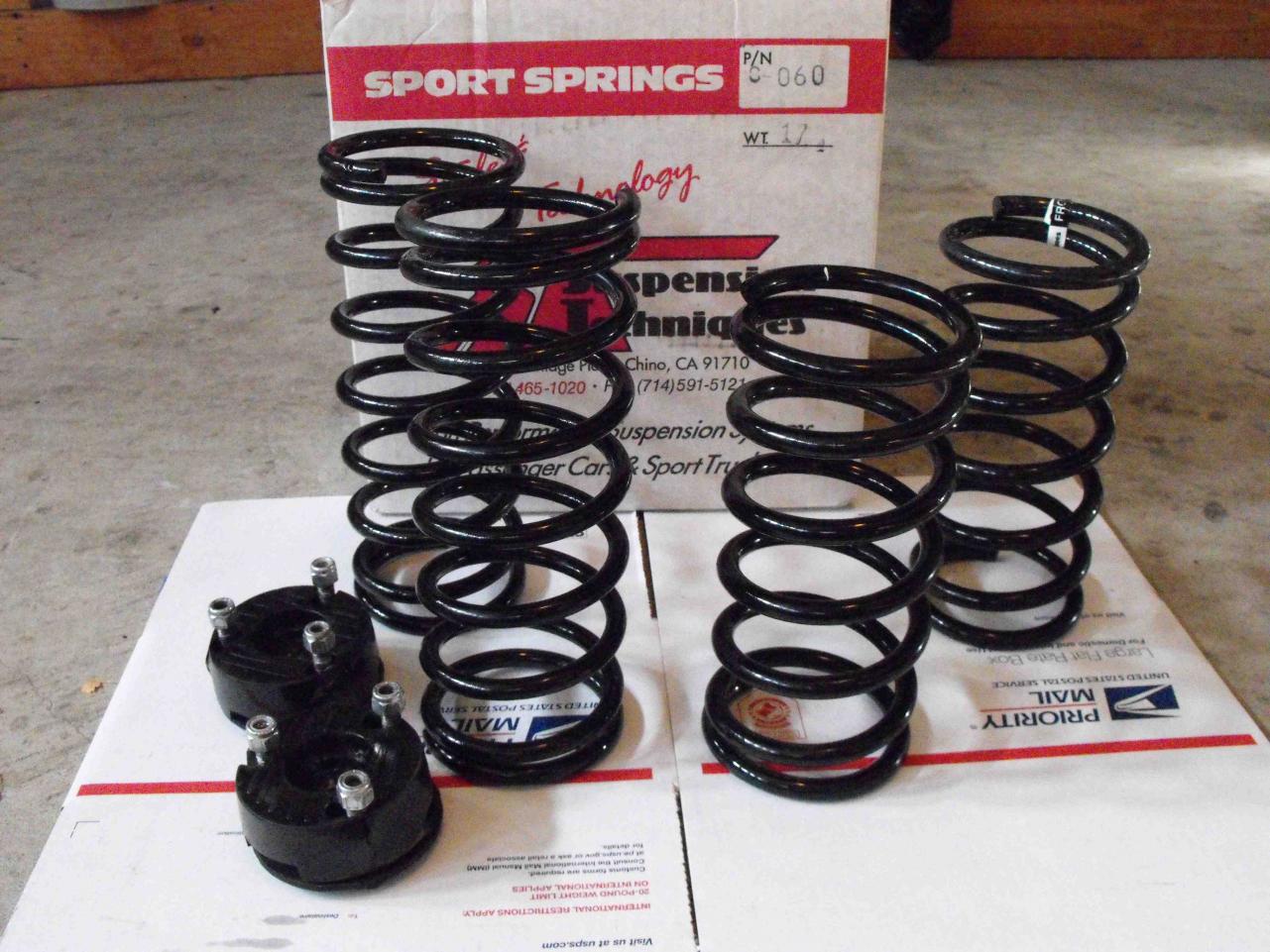

Boy I have a lot to say on this issue. One other factor that must be considered is the tires and rims that accompany the spring shock set-up. These also play an important factor in the ride and handling of the car. Another factor is personal preference, of course. I think my son and I are at opposite ends of the spectrum. He wants a car that rides on rails around the race track, and I want a car that I can drive everyday without getting beat up.
Over the last month I have done one tire set change out, and 4 spring configuration changes (yes, that equates to 16 spring swap outs. I am pretty good at it now). All this was done in the effort to produce a decent ride for my daily driver, a 1971 240Z with an L26, 5 speed and LSD. I was looking for something that was both comfortable and yet sporty.
The initial configuration was the Tokico Illumina adjustable struts, Tokico 5020 Springs,195/50 Yokohama H4’s(AA traction Rating) on Konig 14” rewinds, 1” diameter Anti-sway bars front and rear, and front and rear shock tower support bars. In this configuration, the handling of the car was incredible. I could rip around corners way faster than I thought possible and the tires would not chirp or make a sound. The car remained flat and had no problem doing more than double the posted speed limits around turns. The ride was like that of a go kart, very stiff. The negative of this set-up is that I spent most of my time trying to dodge potholes and maneuver around speed bumps during everyday driving. On speed bumps, I would get the occasional scrapping. Bumpy roads were brutal . On some speed bumps, I would bottom out, so had to be very careful in parking lots. So, the car was great down the backroads, but not practical as a daily driver.
The first change, and very significant, was the tire/rim change. I replaced the 14” Konig Rewind set-up with 16” Panasports and 205/60 Yokahama YK520’s (A traction Rating). This was a big improvement as I no longer had to dodge the speed bumps. They also softened the ride up a bit. In spirited driving, however, I could here the tires groan a bit and also felt a bit of mush that I did not feel with the earlier set-up. I also liked the final 5th gear drive ratio for freeway driving. With the ~15% Diameter increase I now am doing about 2800 RPM and 80 MPH (Typical CA freeway speed). This is pretty nice for gas mileage I am thinking. The Konig set-up was doing 70 at 2800 RPM. In spite of the improvements, I still wanted a softer ride. So, I decided to take off the Tokico springs and put on some Suspension Techniques (ST) Sport Springs.
While putting on the ST springs, I was a little spooked by the loose fit of the springs on the fully expanded strut on the fronts. So, I ended up running the ST rear springs in the front (They fit better) and keeping the Tokico springs in the rear. This was not much different than the four Tokico’s and offered no improvement.
After getting some reassurance on the ST spring fit, I installed all 4 on the car. The front of the car sat about the same height as the Tokico’s but the rears sat way low, about 2” lower. The top half of the tire was hidden in the wheel well (wrong springs?). This definitely would not do, so I put in a two inch spacer to get the rear height correct. With this configuration, the ride was a bit softer than the Tokico’s, but not much. Still not what I wanted. Found myself still dodging potholes and large bumps.
Finally, I opted for the stock springs in this set-up. This is what I want! Soft enough to drive every day, but solid enough to take a spirited drive down the long windy roads. It is a very nice compromise. In addition, I can now use the adjustability of the Illumina’s. On all the previous set-ups, I had them on the softest setting (1) . Now I can dial them in. I currently have the fronts set at 3 and rears on 2.

Posted
ST Springs with 2" spacer
You ought to seriously consider returning that poly isolator. It's a bad idea to use polyurethane in that spot. It is too stiff, and requires too much force to change the angle of the strut. Rubber isolators are much better.
