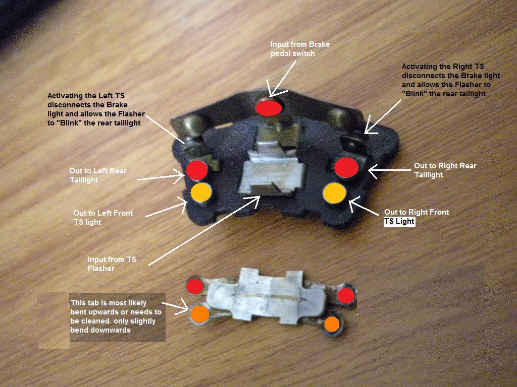

The front turn signals and dash signal lights are connected together, where as the rear turn signals are also brake lights. If they weren't seperated like they are, the dash lights would come on every time you hit the brakes.
Now on to the problem.... You've made so many left turns that you've bent the front left tab inside the switch. If you'd like to take it apart and fix it, use the diagram below to help guide you as to which one is bent. Give it a slight downward bend towards the contact. NOT TOO FAR or the turn signal will stay on all the time. While it's apart, use a very small dab of di-electric grease on the ball bearing's slide area, after you clean the old crap off.
Then use some more dielectric grease to hold the ball bearing to the spring while you re-assemble the switch.
ONLY bend the small outer tabs out a little to dissasemble the switch, so they don't break off.

Well I found out what the problem was... It is the little plastic slider that attaches to the turn signal Lever or arm. When i tried to engage the left it had so much play in it that it would not fully complete the transition on the main switch. The switch looked to be in pretty good condition.
So I did a temporary fix by applying a small o ring in the plastic slider Located between the arm and switch where the switch nipple goes and it seems to have fixed the problem.
