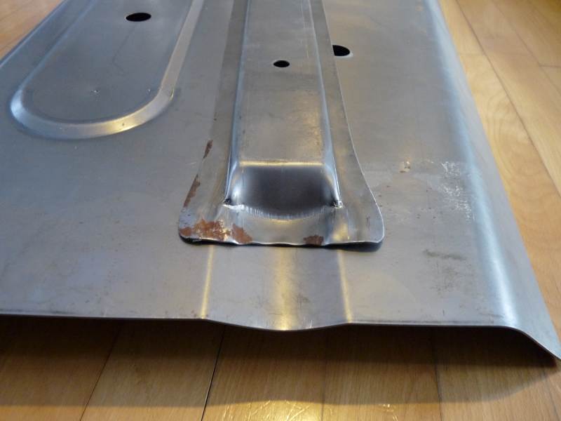

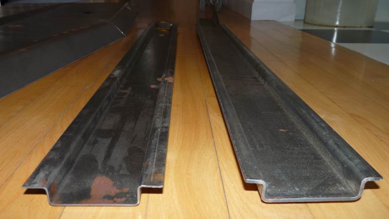

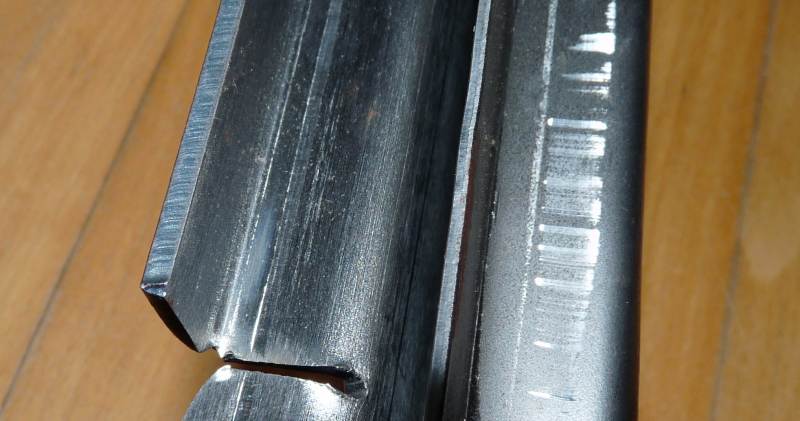

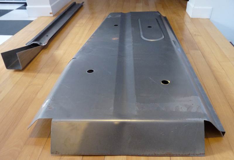

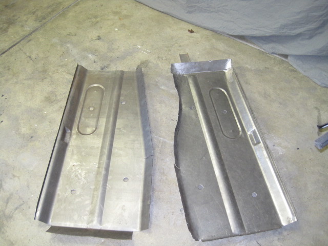

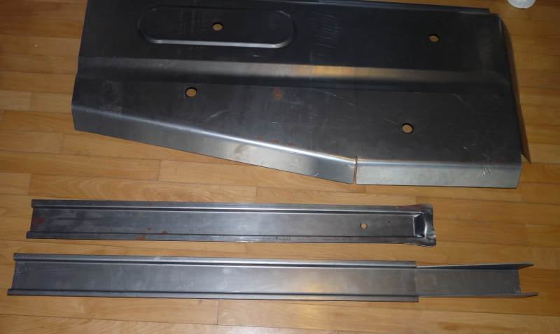

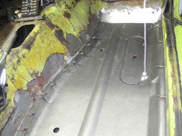

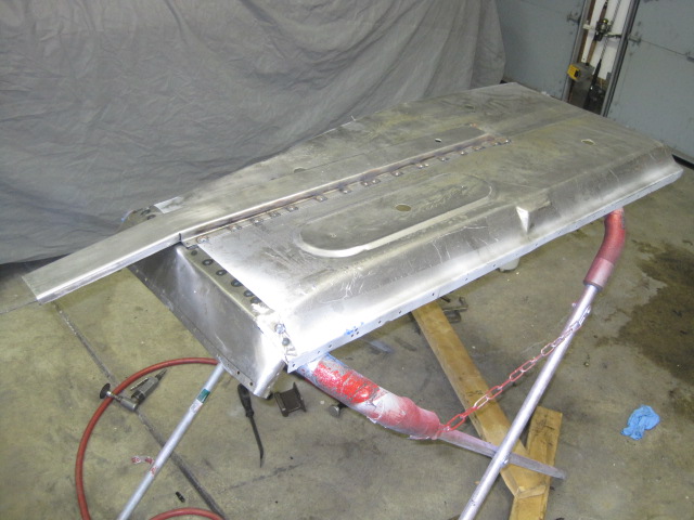

Like John said-definitely not plug and play. Here some pics of the ones I did on a 73 240. Notice a new untouched pan next to a worked to fit-pan. The pans do not follow the tunnel at all, you have to beat them into submission. I spent probably 40 hours doing this car-because I'm not a bodyman, plus if your rust gets into the foot boards the panels don't cover this. Also, the outboard edge radius is too deep which can put your floor at an angle if you don't catch it. Of course I have ordered panels for a 69 Porsche 911 that weren't any better-welcome to the world of aftermarket!
