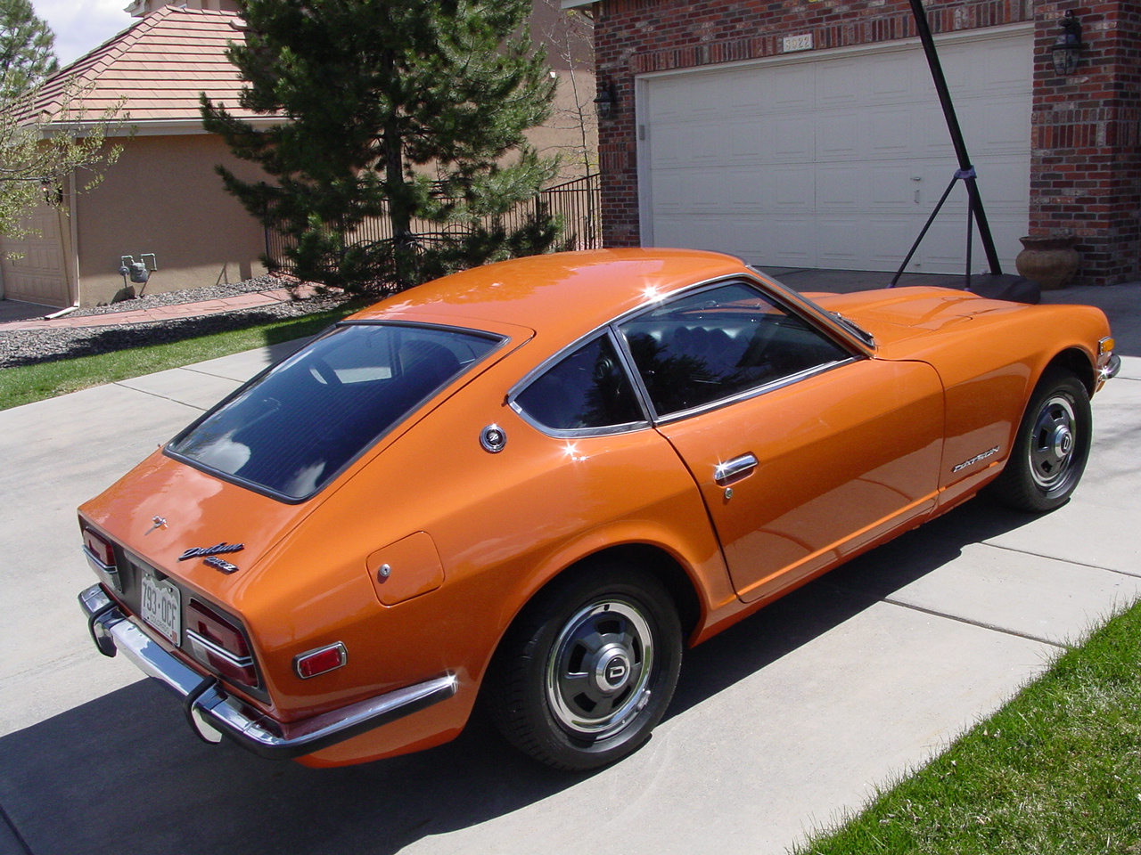

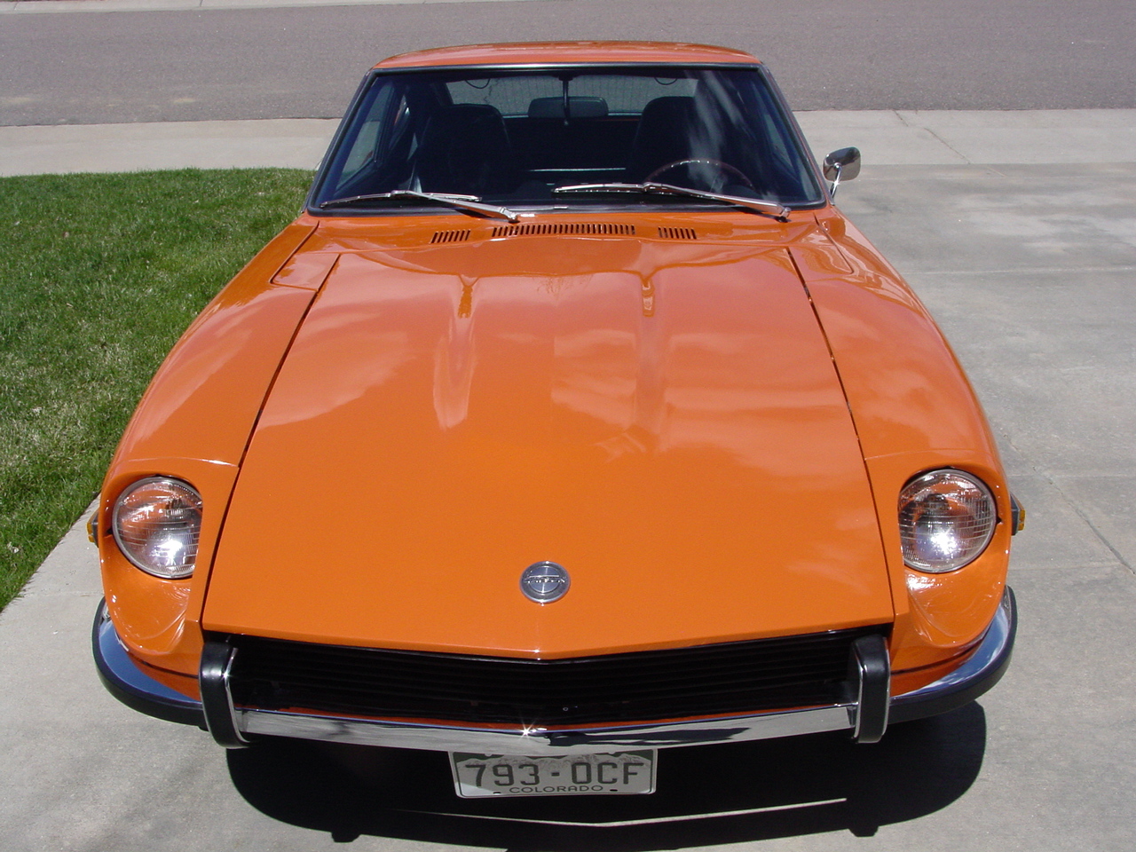

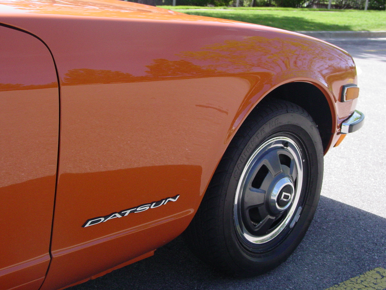

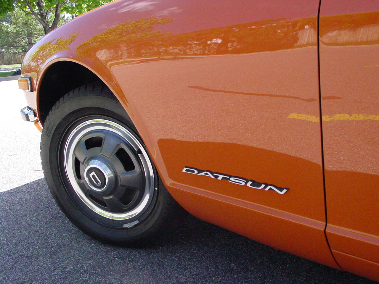

October 5, 201014 yr comment_332568 I prefer the Dupont Chromo-based paints. My son and I used to have a '71 with 918 Orange. It was painted with a 2-stage paint process using Dupont Chromo-base paint and then the clear was applied. Here are a few pictures of the car shortly before we sold it in 2007: Link to comment https://www.classiczcars.com/forums/topic/37293-918-orange-ppg/#findComment-332568 Share on other sites More sharing options...

October 6, 201014 yr comment_332664 That is one lovely orange Z Steve. It's so shiney! Do you have to wear sunglasses to protect your eyes from the glare? Truely a car to be proud of... Link to comment https://www.classiczcars.com/forums/topic/37293-918-orange-ppg/#findComment-332664 Share on other sites More sharing options...
October 6, 201014 yr comment_332675 Thank you, Julio. My son and I miss the Orange Z since we sold it over 3 years ago. Link to comment https://www.classiczcars.com/forums/topic/37293-918-orange-ppg/#findComment-332675 Share on other sites More sharing options...
