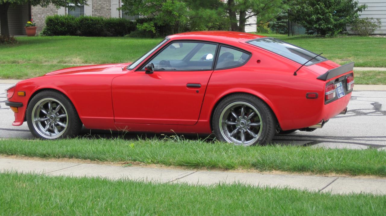

17X8.5 +4 wheels with 245/45 tires are not plug and play---ask me how I know:rolleyes:---but they look great!
There is a thread somewhere on here or on hybridz that describes what I went thru. Still have rubbing on the rear inside the wheel well that i hope a slight camber change will fix, but flares would be the best solution.

I do not have any personal pics, here is a thread that should give you an idea of what they would look like:
http://www.classiczcars.com/forums/showthread.php?t=40526
