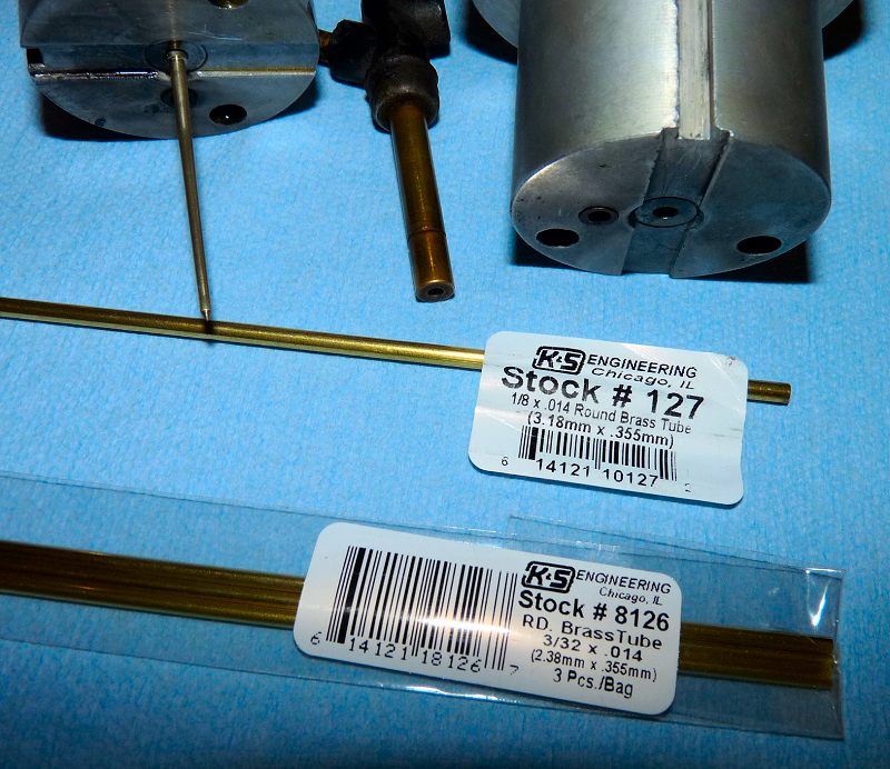

The Parts:

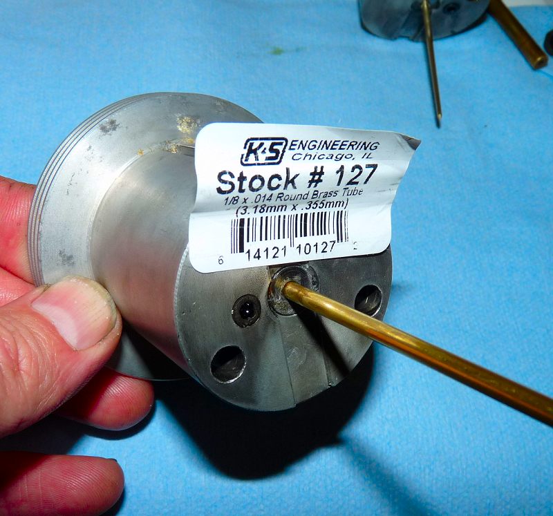

As you can see, the stock hollow brass tubing is what I used. The sizes are 1/8" inch and 3/32".
The cost was very favourable as well.....well a bit more than a rivet or screw but hey ~$3 is mighty fine for a specialty tool. I might add that this is the only special tool I know of that is needed to easily rebuild SU carbs.
How Each Part Works:

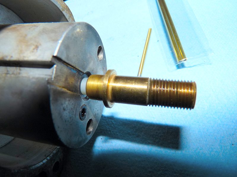

The bigger 1/8" (3.18mm) tube fits snugly into the piston.
The smaller 3/32" (2.38mm) tube fits very well into the jet nozzle.
The smaller 3/32" tube also fits nicely into the 1/8" rod
So to make the tool, I cut an 8mm length of the 1/8" rod. Slid it on a 50mm length of the 3/32" rod then soldered them together.
Some sanding of the solder and a little off the 1/8" rod (3.18mm to 3.00mm) completed the job.

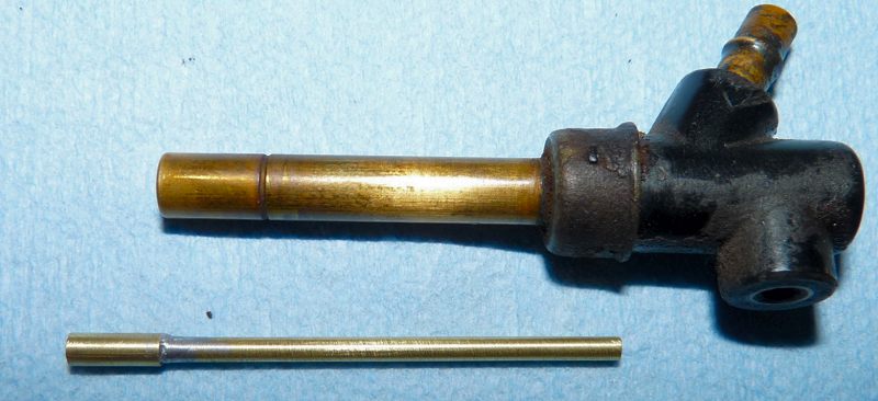

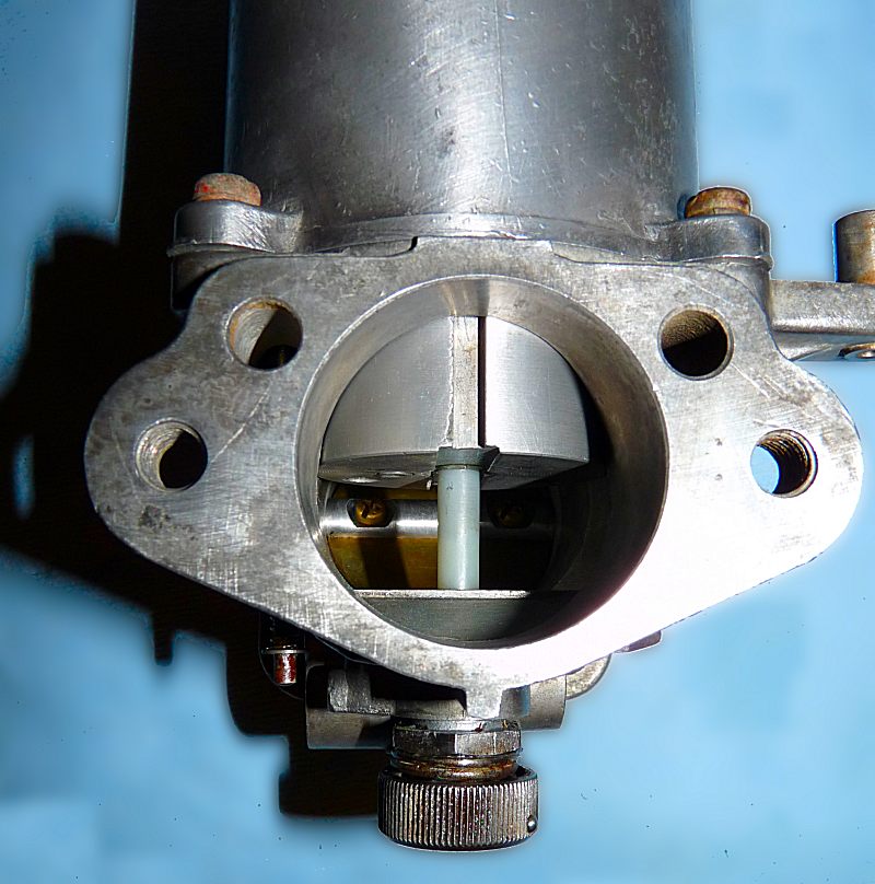

The completed tool below a jet nozzle.

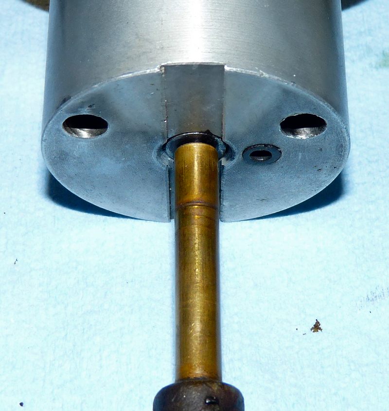

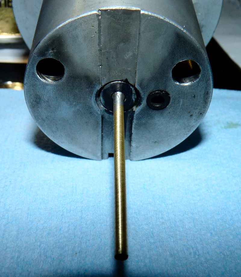

Here is the tool in the piston.
Here is the jet fitted by the tool.

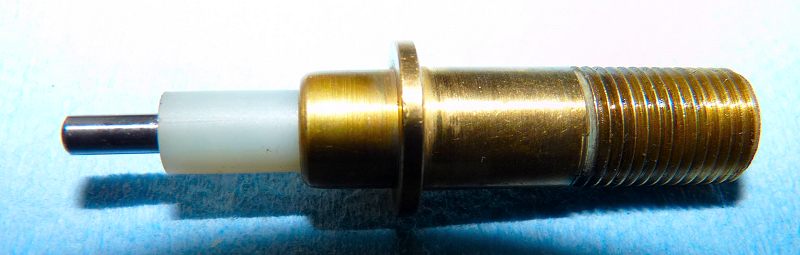

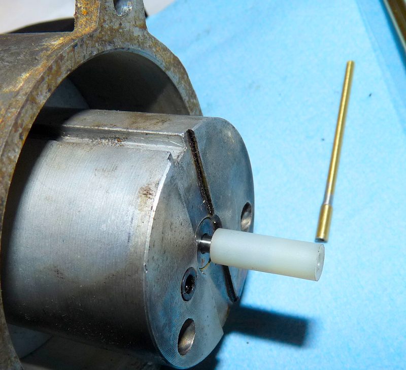

It should be better than Mk-I because it aligns the nozzle guide directly rather than aligning it through the nozzle. This reduces the error/slop that exists between the nozzle and the guide.

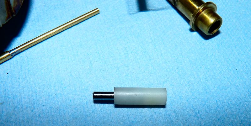

It consists of one 1/8"dia X 3/4" metal pin and one 1/4" dia X 23/32" long nylon spacer with 0.110" ID.
Just tap the pin part way into the nylon spacer and that is it.
Mk-II Parts: Steel Pin and Nylon Spacer
The nylon spacer fits in the jet nozzle guide.
The steel pin fits into the piston's needle hole.
All three parts aligned
Ace parts 44237-C (nylon spacer) and 58011-K (steel pin)
