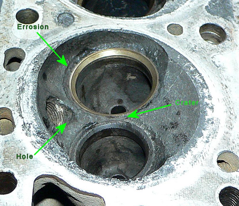

August 8, 201113 yr comment_363551 This is #6 in the E31 I am restoring. Looks like water but maybe detonation? Sure it can be ground and welded up then machined back to shape like a racing head plus new seats but I went for a Maxima N47 with custom cam from BMC in Arizona.... and probably saved $. Unfortunately, I am now reassembling and noted the corresponding piston top from #6 is peppered with small holes and it is 5grams less that the others. I may need that tended to with a welder and surface grind. Edited August 8, 201113 yr by Blue Link to comment https://www.classiczcars.com/forums/topic/40430-cracked-head-in-need-of-an-experts-opinion/#findComment-363551 Share on other sites More sharing options...
August 8, 201113 yr comment_363564 Blue,Your head looks like electrolosis erosion to me. The main reason I reply, is to try to convince you not to weld a piston dome. The piston dome is not that thick, and the welding will likely distort the top ring groove. The top ring groove is probabbly worn out anyway. To check, lightly glass bead the piston top groove, install a new ring and check the ring land clearence with a feeler gauge. New pistons will have a land clr. of .001 - .0015. At around .004 clr. the groove will not support the ring properly and it will lead to compression loss. My 2cents, and FWIW, and I've been there many times.Phred Link to comment https://www.classiczcars.com/forums/topic/40430-cracked-head-in-need-of-an-experts-opinion/#findComment-363564 Share on other sites More sharing options...
