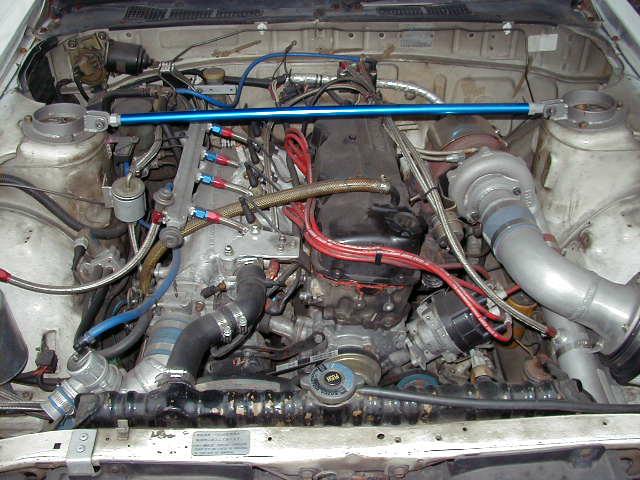

sjcurtis Posted February 12, 2003 Share #11 Posted February 12, 2003 Wish I could buy this L28ET combination (front cut complete) from an importer in Aus My 2c Steve:classic: Link to comment Share on other sites More sharing options...
