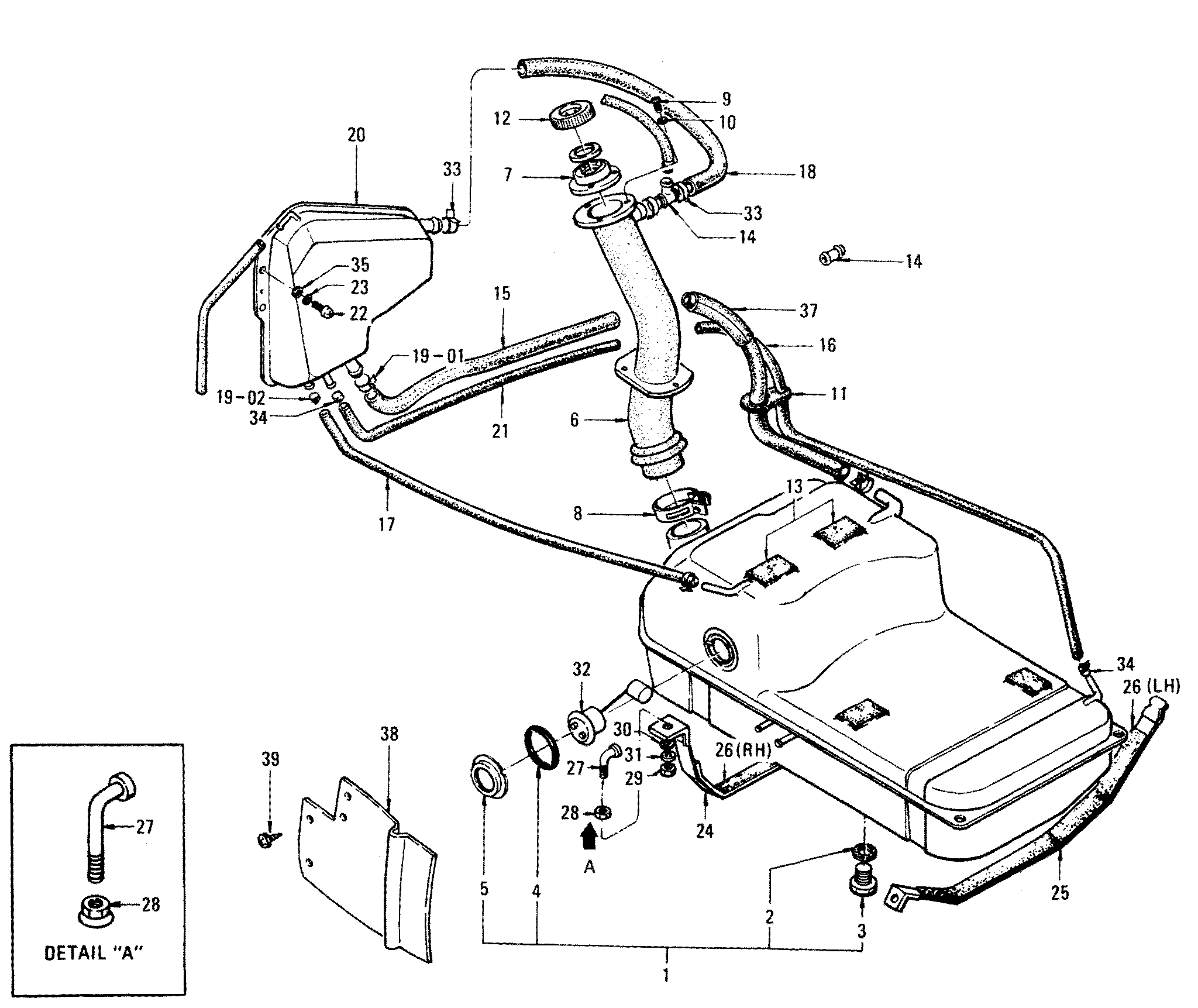

Well i just got number 17 from EBAY yesterday! I would like to know which of this hoses shown in a diagram must be strictly original due to their stock bendings so i can look for them?
Parts number will help!! Edited by jalexquijano

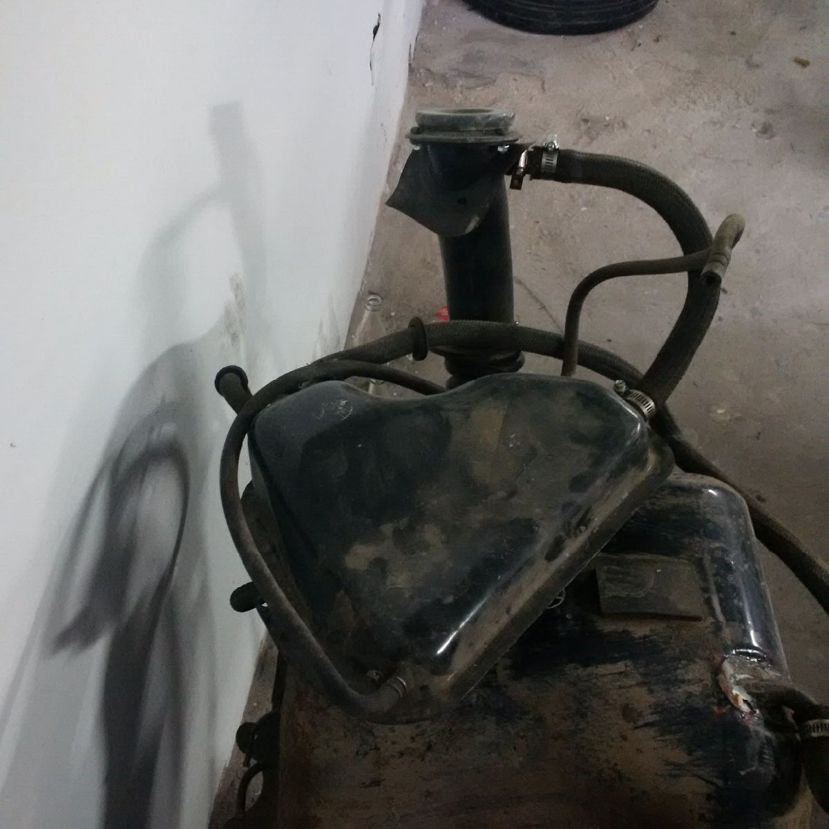

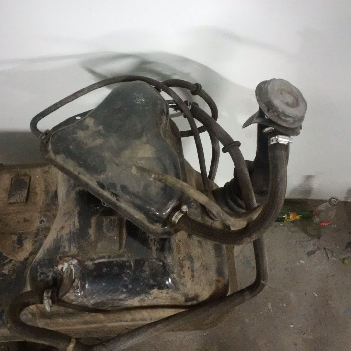

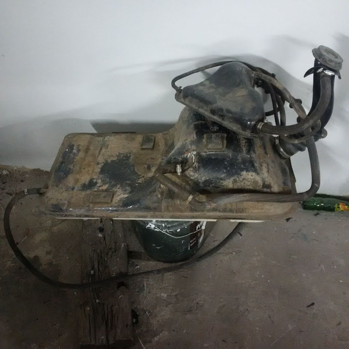

Well i just had the paint shop take the complete fuel tank, vapor tank and hoses out of the car. At the moment i have only been able to purchase the following hose:
http://www.ebay.com/itm/Datsun-240Z-260Z-1970-74-Fuel-Gas-Tank-Vent-Hose-OEM-NEW-796-/222070495916?fits=Make%3ADatsun%7CModel%3A240Z&hash=item33b46edaac:g:MQUAAOSwgQ9Vks~A&vxp=mtr
I read that Z car source has a kit that comes with all the hoses but are not preformed. Which other source can i use to get the correct preformed hoses? I would not like to remove any of the hoses until i can source them all.

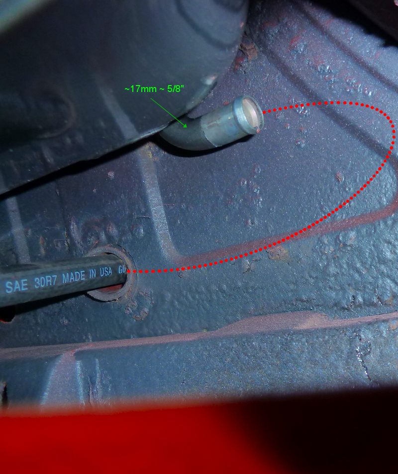

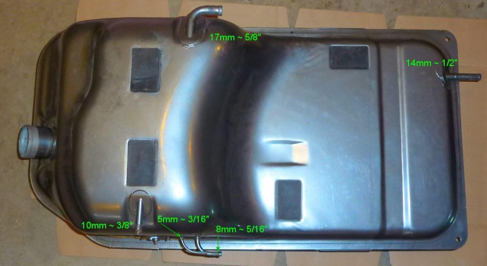

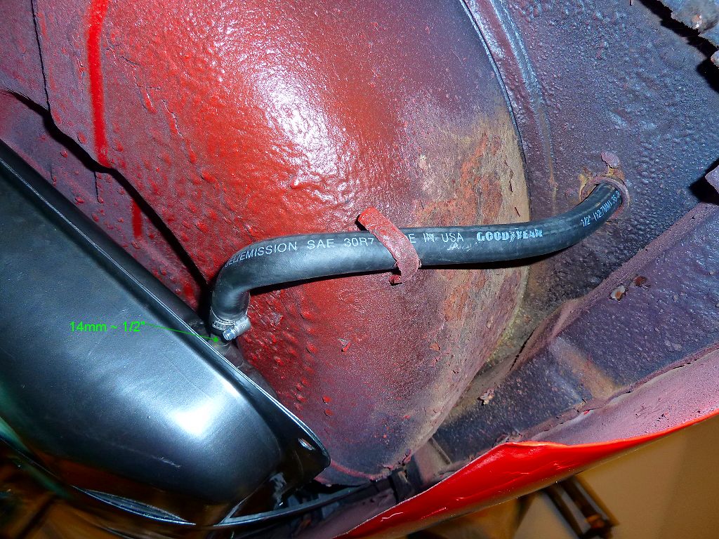

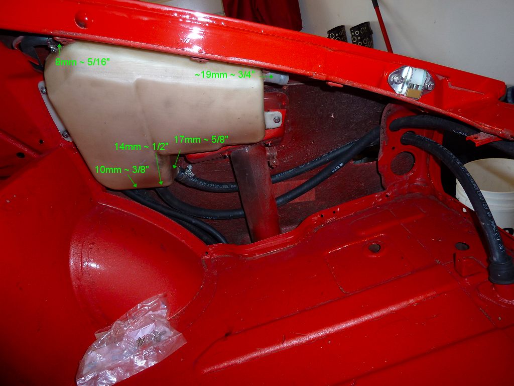

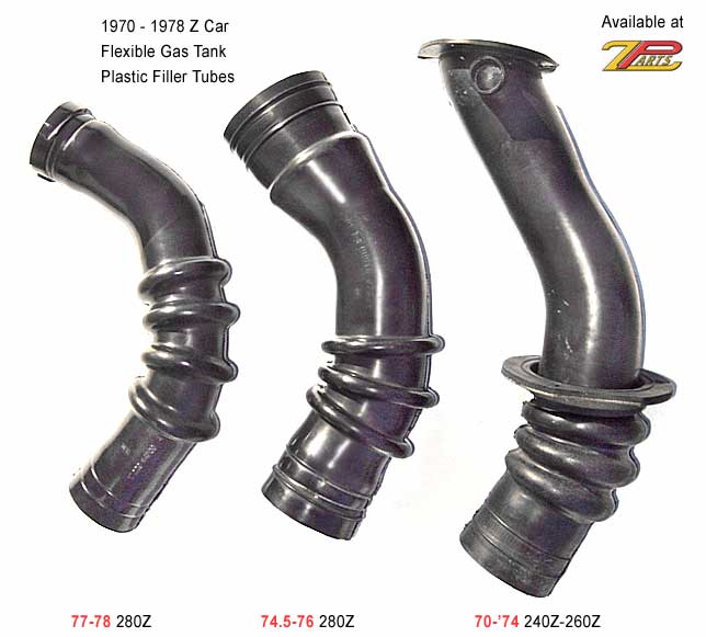

On ‎03‎/‎16‎/‎2016 at 3:50 PM, Jarvo2 said:
Try McMaster Carr, they've got the best selection.  Here are a bunch of pictures that might help in your journey:

In an attempt to track down the gas smell I've pulled the gas tank and set about replacing hoses only to find a crack in one of the fittings.    Problem is that I cannot find one anywhere . I'm also struggling to find any other link to  the attached schematic that shows #14
