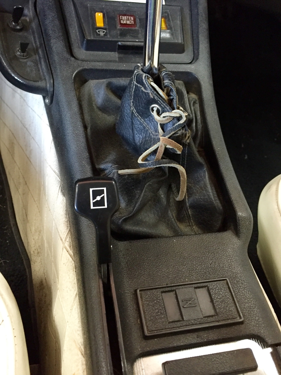

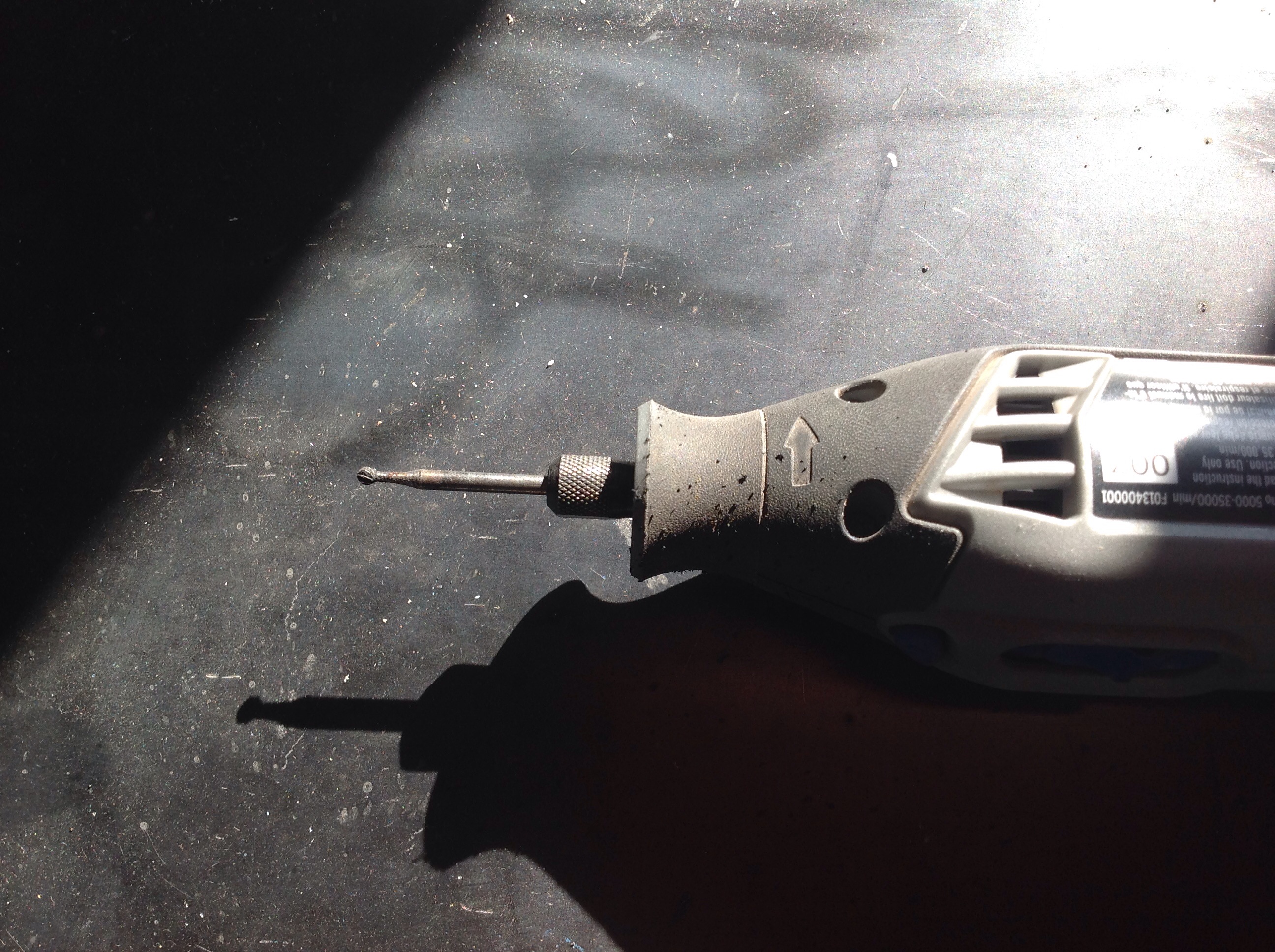

Turns out Namerow and I had the same 70-71 knob so I went the modify route.
Used a meatball dremal grinder bit to widen the width of slot, the base widens so the knob slots needs to be filed out. I widened it slowly so the fit remained tight. Also drilled the grub screw hole to 1/8"image.jpg
im very happy with the resultbut picture shows Lots of work to do on this interior :(
