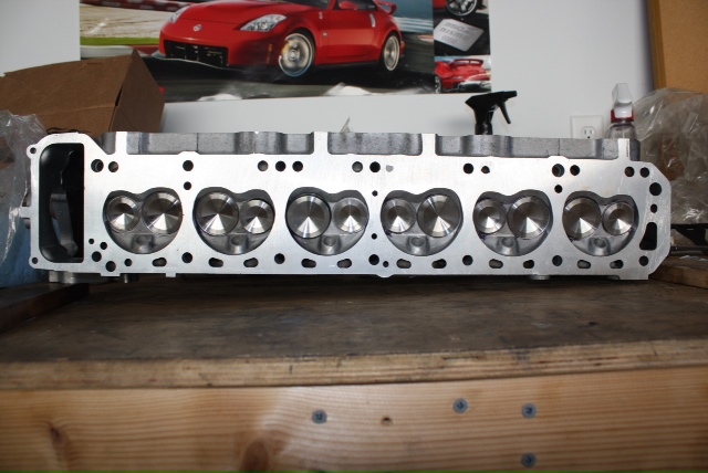

I use a E88 head with bigger valves like your N42.

..Eiji uses the N42, so you'll be OK with your head. BTW, where did you source your KA24E pistons?
@Diseazd Any idea what cam specs Eiji has in mind for your build? A CR of 12 sounds pretty agressive to me, especially with 93 octane fuel. However, good to know that Eiji uses the N42 head, too! I don't think I'll have clearance issues since I use the 8mm 240z rods (not the 9mm ones, but I got upgraded ARP bolts). I got the pistons from Rockauto, pretty cheap tbh (I think something around $180 for the set of cast ITM 89mm pistons).
