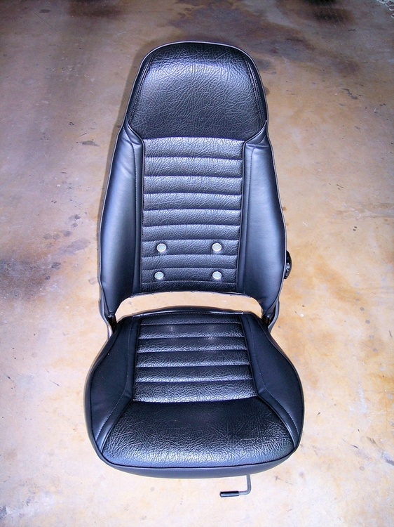

I recently put new foam on from one of the kits out there, that and the repro seat bottom (too lazy to do the top, besides it looks fine), anyway the new foam was thicker that the old, and the seat is fine for at least the 150mile trips I have been making. One thing if you get the repro cover you will need to get new foam or at least add to what is there, the seat cover is too big if you use the old stock foam.

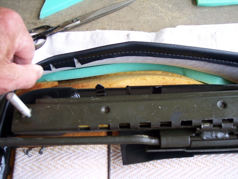

I reworked my seats as part of the resto project a few years ago.  I found the OE foam to still be in good shape but decided to firm up all the contact surfaces with an extra layer of upholstery foam.  I went to a fabric store and bought 3 yards of 1/2" foam and then cut pieces for the side bolsters and middle of the seat back, the same for the side bolsters,thigh support and middle of the seat bottom.  I also added foam around the seat bottom skirts to help fill them out (pic).  The extra foam for the contact areas has made a significant improvement in comfort and support.

I did the same with the seats from my 5/70.  The original foam was not bad, but I needed to fill out the new seat covers.  I used various combinations of 1/2" and 1/4" foam, plus 1" batting (fabric stores have this -- it works well for filling in 'holes').  Where appropriate, make your cuts in the foam at an angle rather than as a straight (90-degrees to surface) cut.  If you cut it straight, the edge of the foam will show through the seat cover as a ridge.  A BIG pair of scissors helps.  Also, an ultra-sharp kitchen knife.
One other caution:  By adding foam in this way, you will be 'over-stuffing' the seat.  Done right, this adds a little extra 'bucket' to the bucket seat.  However, it can lead to puckering if you pull the buried tensioning flaps too tight.
