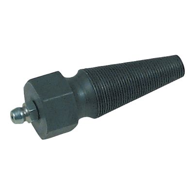

I read several posts about using bread or grease to pop the old bushing out.  My original one did not want to come out that way or with the tapered screw-in grease zerk shown below.   I ended up getting a removal tool from harbor freight and grinding down the claws to where they would fit inside and pulling it out that way.  It was a super cheap version of the bottom picture
