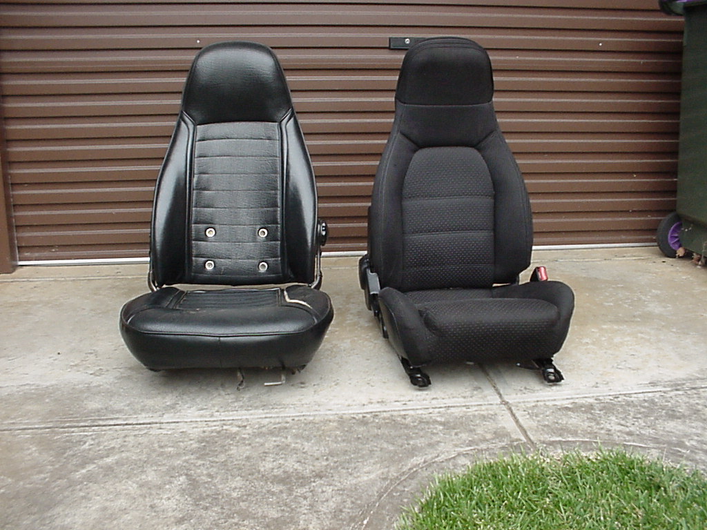

Someone asked me to post some pictures of the Miata seats I recently wacked into my '71, so here goes....
They're very similar in shape to the OEM seats, comfortable, have speakers in the headrests, and are *way* less likely to fry your thighs after a day parked in the Australian sun.
I used the Miata rails, drilling a hole in the front section to match up with the front mount on the floor pan. Then simply drilled 4 holes in the mounts (2 to match the new holes in the rails, 2 to match the existing rear holes), wriggled things about, and bolted them in. I've still got some overhang (the Miata rails are longer than is required) and will cut it off in due course.
Relatively simple exercise and a useful alternative for a DD.

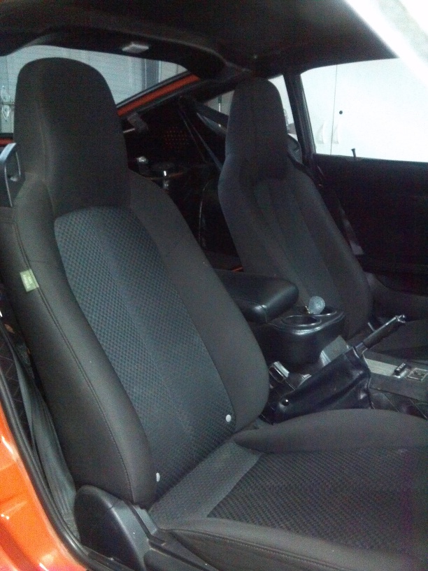

I have Miata seats in my 240. They hold you in WAY better than stock and the cloth is much more comfortable.
I paid $40.00 at the wrecking yard for them , and around $12.00 for 2 cans of spray dye. I used stock 240 sliders and put a 1" tall aluminum shim under the rear of the seats since they sit a bit lower. I did not have to drill new holes into the seat base on the driver's side. On the passenger's side had to drill 2 new holes.
Forget the early Miata seats. I ran with a pair for about 3 years until I got a screaming deal on a pair of 2008 MX-5 seats. They are just as easy to install as the early Miata seats though they do require a little bit more work.
