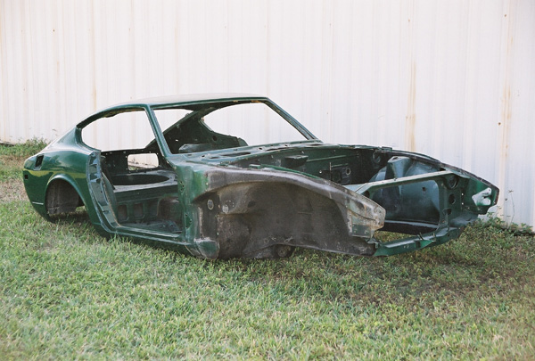

I'll be stripping down to the unibody and welding in new floors and patches and wondered if it was best to strip off all the existing paint, while removing undercoating and rust.
One thought led to another and I starting looking into places that will dip the who vehicle. Sure enough, for $1000 ($$$$$) a place will dip the whole unit. All the paint, rust, undercoat (everything not metal) will be GONE!!
Ready for patch/prime. Anyone ever done this? I realize, though, afterwards, the original sound deadening in the hatch would be gone and would need replacement if intending to make 'original'. Is that stuff even available?
Anyone ever done the dip?

I thought I would tac on to this thread to share my experiences. As ya'll may know, I am dipping Her Majesty the 26th to remove the rust and prepare her body for restoration.
There is a business in Wauchula, Florida that dips car bodies and parts in an alkaline electrolytic solution to remove rust. An electric DC current is passed through the tank (with submerged car body) and the "ferrous ions" - rust - are separated from the metal - completely. Her Majesty is there awaiting the magic spa and I expect her nude return in March.

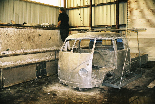

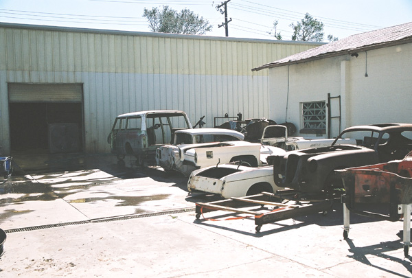

Revivations is charging me $1,391 for the body shell - priced at 158 inches long. Here are some pictures of the facility. You will see a 1600 body shell in line ahead of me along with a T-bird, Jag, and some trucks. Trucks seem to be quite popular these days. The car will be placed on a cradle and lowered into a tank full of degreaser and paint stripper for approximatley two weeks. Then it will be pressure washed to remove the seam sealer, insulation, glue and other goo. This process does not harm the lead filler or some of the plastic coatings like around the wiring harness ties. Then the car is submerged in the alkaline solution and de-rusted. It sits in that tank for another week.

The last picture shows a VW pick-up next to the electrolytic tank. There is a cradle in the tank. I don't know if the VW is going in or coming out. There was also a Pantera and another Jag in this building.
