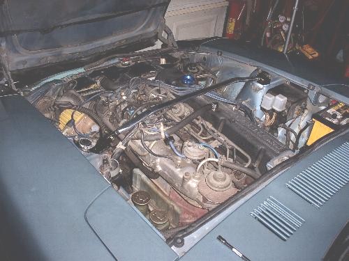

February 13, 200421 yr comment_68384 If the strut bar has rod ends, then they should be adjustable. Rod ends do something else for you too. Rigidly mounted strut bars will flex from bending forces. Rod ends prevent the bending forces from being applied to the strut bar, yet allow the strut bar to do it job. Link to comment https://www.classiczcars.com/forums/topic/10166-honda-strut-barbrace-for-z/?&page=2#findComment-68384 Share on other sites More sharing options...
February 13, 200421 yr Author comment_68390 Yes, the strut bar is adjustable on both ends. It does this by screwing in or out on a threaded bolt, with a nut to lock it in place. I still haven't modified mine, just checked it for fit and looks like it will work just fine. Hope this helps. Gary Link to comment https://www.classiczcars.com/forums/topic/10166-honda-strut-barbrace-for-z/?&page=2#findComment-68390 Share on other sites More sharing options...

February 18, 200421 yr comment_68976 I don't know where this idea came from, but on my 78 it doesn't work. A friend down the street has a couple of Hon-duhs and had one of these bars for a 93 Civic laying in the corner. I took it home, drilled the holes and my hood won't close. My opinion: Waste money trying to make something fit that wasn't designed for you car or buy the right part. You make the call! Fortunately, this guy owed me on for getting his car running last weekend! Link to comment https://www.classiczcars.com/forums/topic/10166-honda-strut-barbrace-for-z/?&page=2#findComment-68976 Share on other sites More sharing options...
February 18, 200421 yr comment_68980 I'm surprised somebody else didn't mention this already-BEFORE you even start measuring your car for a brace or bar, you need to make SURE your chassis is in albsolutely PERFECT ALIGHMENT! Otherwise, you'll be locking it into whatever ****-eyed geometery it's in. That's what the strut bar's job is, but NOT what you want to do with it. You want to lock the (properly aligned) chassis so it doesn't change/move when you turn.BTW- .02 cents is $0.0002! Link to comment https://www.classiczcars.com/forums/topic/10166-honda-strut-barbrace-for-z/?&page=2#findComment-68980 Share on other sites More sharing options...
February 18, 200421 yr comment_68991 A front and rear strut bar keeps the vehicle in a "square" (for lack of a better word). Thus keeping body roll down to the very minimum. Of course beefier struts and springs can only enhance the purpose of the strut bar, as far as stability.Vicky I guess I should say 2 cents, right? Link to comment https://www.classiczcars.com/forums/topic/10166-honda-strut-barbrace-for-z/?&page=2#findComment-68991 Share on other sites More sharing options...
February 18, 200421 yr comment_69003 Originally posted by TomoHawk I'm surprised somebody else didn't mention this already-BEFORE you even start measuring your car for a brace or bar, you need to make SURE your chassis is in albsolutely PERFECT ALIGHMENT! Otherwise, you'll be locking it into whatever ****-eyed geometery it's in. That's what the strut bar's job is, but NOT what you want to do with it. You want to lock the (properly aligned) chassis so it doesn't change/move when you turn./QUOTE] YOU mentioned it earlier in this thread. My car was recently aligned. 4 wheel, I do it once a year. I was just curious (and skeptical) about this Honda strut tower thing and when I saw an opportunity to try it for free, I went for it. Even if it would have worked it just seemed too flimsy for a Z. I question its necessity on a street car anyway. Link to comment https://www.classiczcars.com/forums/topic/10166-honda-strut-barbrace-for-z/?&page=2#findComment-69003 Share on other sites More sharing options...
February 18, 200421 yr comment_69006 Things in your vehicle will stay "square" with a strut bar installed ONLY if the vehicle is "square" to begin with. You can't "square" things using the strut bar- they aren't meant to correct the vehicle's geometry. You'd need an alignment machine, or to replace bad struts or whatever was bent to fix things. Link to comment https://www.classiczcars.com/forums/topic/10166-honda-strut-barbrace-for-z/?&page=2#findComment-69006 Share on other sites More sharing options...
