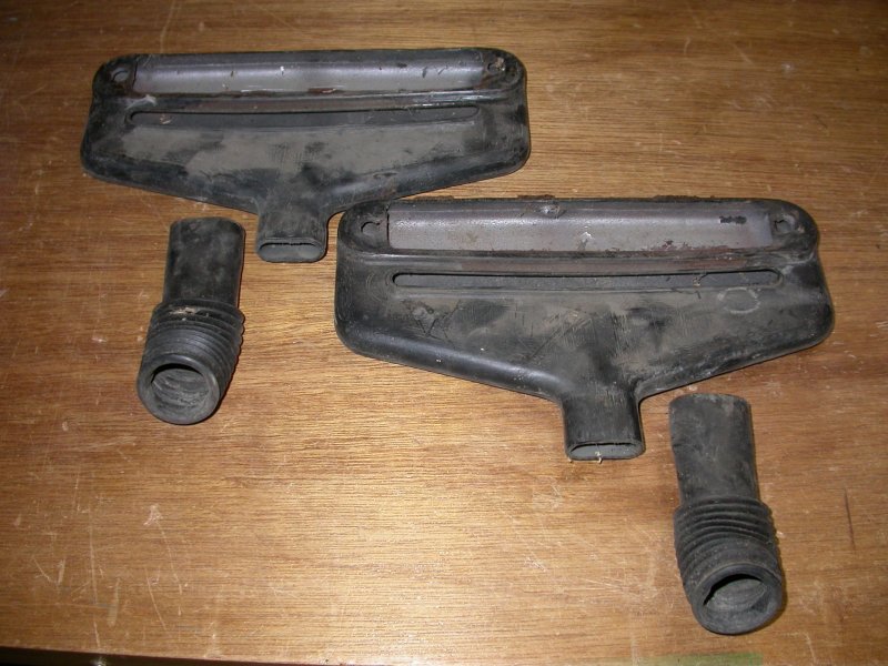

February 27, 200421 yr comment_70238 I didn't know, but I guess I'm convinced now that the vents/drain tubes in a box the PO gave me are probably original to the car. The tubes are rubber, and are in good shape. Pliable and all. The vents are kind of rough. Link to comment https://www.classiczcars.com/forums/topic/10408-hatch-vents-and-tubes/?&page=3#findComment-70238 Share on other sites More sharing options...
