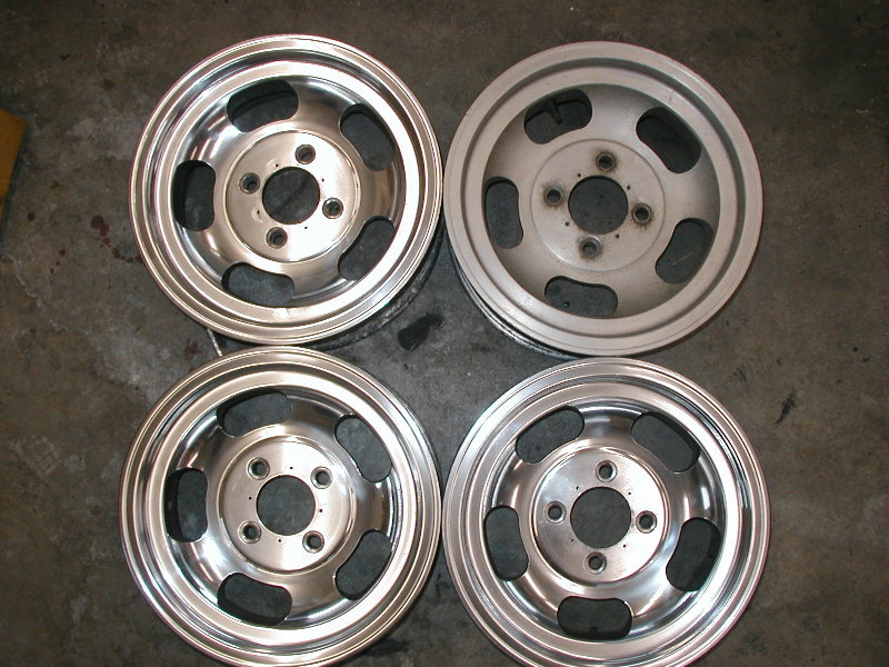

One more to go for my slots. I used 600,1000,1500 then hit it with my 8" buffer Black, Brown and then white. Took about 3 hours each and my back is killing me!

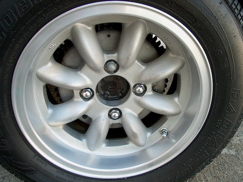

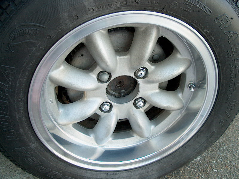

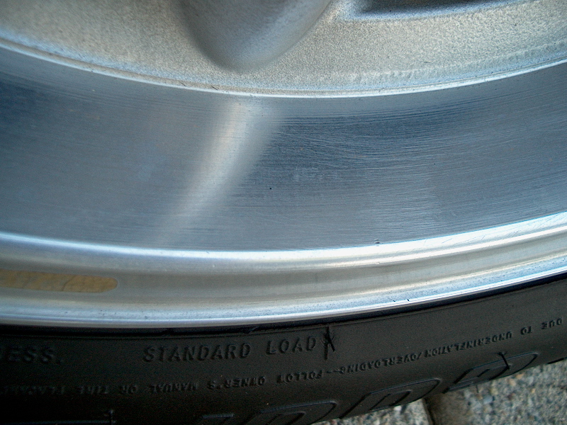

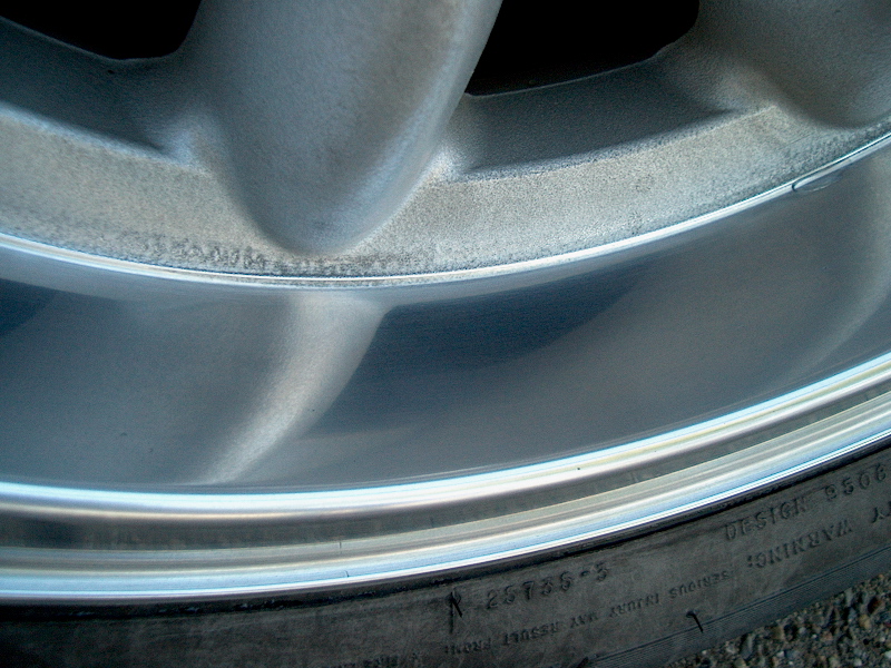

ok i didnt read every post on this thread but this is my story. i took bens advice, i went 220, 320, 400, 600, 2000. i couldnt find 1000 or 1500 but i woulda done that too if i had them. i finished it off with a chrome polish called neverdull. it worked superb! here are a couple before and after pictures.
this first one is a before
