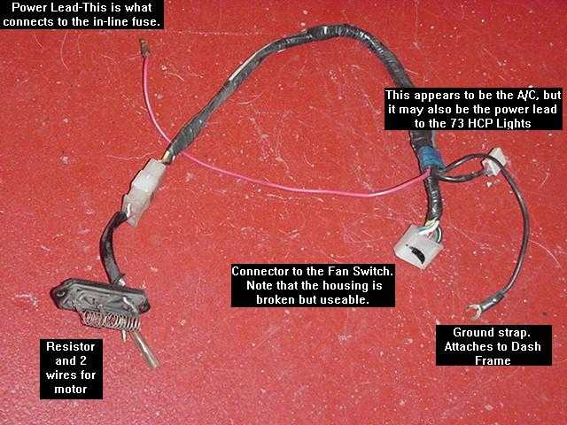

So on that picture (and on the blower harness) there's the connector that connects to the blower speed control switch, and branching off from that is a little 3-prong white plastic switch with two wires coming out of it, blue and red. Now, where does THIS plug into, and am I at all close in assuming this is the power? Being red and all...if this is the power, it might explain why I have no power to the blower...as this connector isn't plugged into anything in my car.
Ok, with that picture I hope you can address whether you need that wiring harness or not.

Will take a look at the wiring tomorrow morning, but if memory serves me correctly, that power lead and ground wire are simply not there on my car. That might explain why the blower isn't getting power =D
Last night, after working from 7:30am till 1:30am, an idea came to me right as I fell asleep. I woke up, showered, and went down to the garage...touched two wires together, and voila. I have a functional blower. Many thanks to Enrique and others for ALL the help (it's been a long, voltmeter-filled journey), and I'm ecstatic...now the real fun begins! Now that the cars lights and signals and such work, it's time to take it into work and change gaskets and boots, seals, bushings, pads, etc. Then off to the body shop for a new rear panel and paint...then into my hands for a daily driver! I'm SO excited. Oh man!!!!! I love this car, and I LOVE this board. =D
