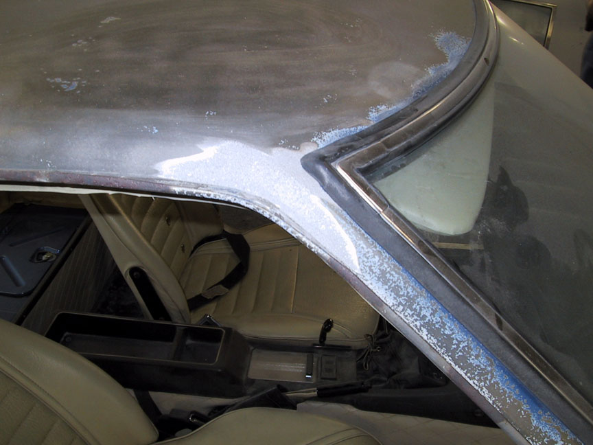

March 15, 200420 yr comment_72691 Here's a pic if the front a pillar on my '73 after getting it back from the media blaster. I never realized there was lead there! Link to comment https://www.classiczcars.com/forums/topic/10538-is-that-a-seam/#findComment-72691 Share on other sites More sharing options...
