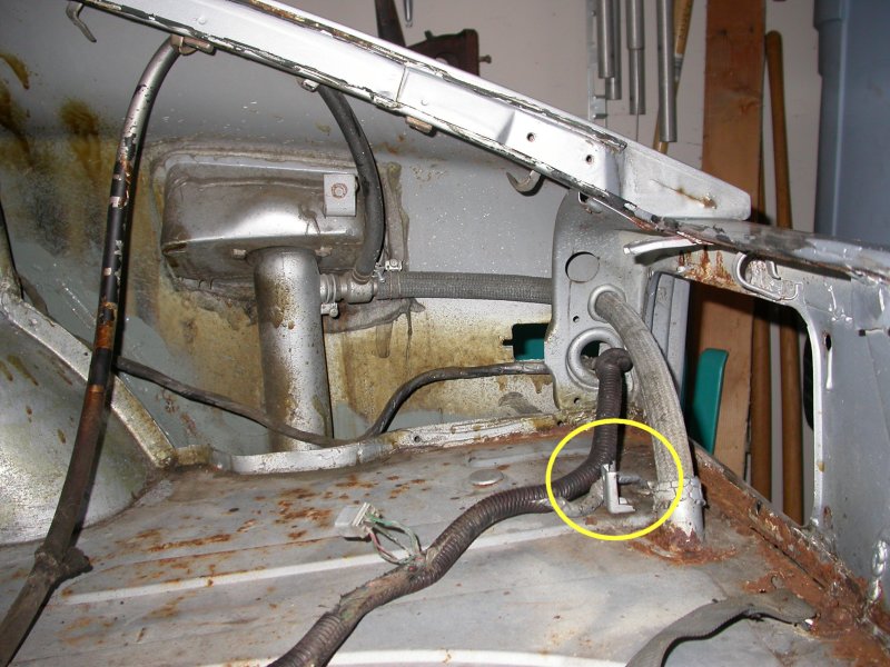

I found my 240Z's rear deck harness is something funny.
For the gas tank wires,which hole does it go into?
I think my 240Z is probably wrong.The harness should take another hole next to the previous one.
Please let me know which hole your Z takes?
kats
Kats:
The hole right by the "Y" in the wiring harness.
All of that wiring will be hidden by the rear hatch plastic cover.
The plug you have in the hole now will be used to plug the hole you are currently using.
