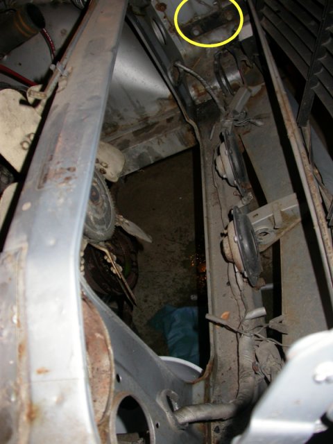

Posted March 9, 200421 yr comment_71932 Does anybody have a pic or maybe can tell me where their 240z front bumper brackets atttch to on the car? This question is for 70 thru 72 owners. Thanks for the help. Link to comment https://www.classiczcars.com/forums/topic/10641-do-you-have-a-pic/ Share on other sites More sharing options...
March 9, 200421 yr comment_71934 There are two bolts each that attach in the space behind the grille but in front of the radiator just below where the hood hinges attach. Link to comment https://www.classiczcars.com/forums/topic/10641-do-you-have-a-pic/#findComment-71934 Share on other sites More sharing options...
March 9, 200421 yr comment_71936 Quote Originally posted by TTDRIVER Does anybody have a pic or maybe can tell me where their 240z front bumper brackets atttch to on the car? This question is for 70 thru 72 owners. Thanks for the help. I don't have many pics of that area before I took the bumper off, but here's a pic from my 11/69 car that should do you. See the circled area at the very top. Link to comment https://www.classiczcars.com/forums/topic/10641-do-you-have-a-pic/#findComment-71936 Share on other sites More sharing options...
March 9, 200421 yr Author comment_71941 Thats what I thought. Do I have to make new holes for the ends of the bumper to attatch to the valance and fender? Link to comment https://www.classiczcars.com/forums/topic/10641-do-you-have-a-pic/#findComment-71941 Share on other sites More sharing options...

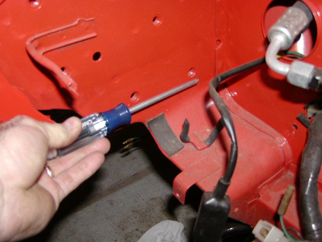

March 9, 200421 yr comment_71945 Sounds like it'll hurt...maybe this will help Above screwdriver...laser pointer stand in. David Link to comment https://www.classiczcars.com/forums/topic/10641-do-you-have-a-pic/#findComment-71945 Share on other sites More sharing options...

March 9, 200421 yr Author comment_71954 Its a 73 and im trying to bring the bumpers more closer to the body. It has holes but im guessing since its going to move back a few inches it needs a new hole. Am I wrong? Please help. Link to comment https://www.classiczcars.com/forums/topic/10641-do-you-have-a-pic/#findComment-71954 Share on other sites More sharing options...
March 9, 200421 yr Author comment_71958 Now that I have tried to do this I know that whoever has said in the past that it is possible to bring the bumpers closer on a 73 by changing just the brackets is wrong. The bumbers are too big on a 73. Everytime you adjust one side the other side sticks out 2 inches. So in my opinion you need to get pre 73 bumpers as well. Does that sound more right to you guys? If you guys have done this please tell me if im wrong or right. Link to comment https://www.classiczcars.com/forums/topic/10641-do-you-have-a-pic/#findComment-71958 Share on other sites More sharing options...
March 9, 200421 yr comment_71963 Pretty sure you're gonna need the earlier bumper to go with the early type mounts. Not only because the ends of the bumpers aren't the same, but also because the "plate" where the bumper bolts to the mounts are also quite different. Link to comment https://www.classiczcars.com/forums/topic/10641-do-you-have-a-pic/#findComment-71963 Share on other sites More sharing options...
