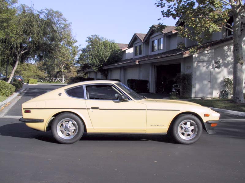

March 14, 200223 yr comment_3976 heres a pic of my lowered Z (or what was once my Z) Its was lowered 1" with Toxico Struts and Eibach springs...u definitely sacrafice ride quality....but they look so much better lowered Link to comment https://www.classiczcars.com/forums/topic/1073-lowered-zs/#findComment-3976 Share on other sites More sharing options...
