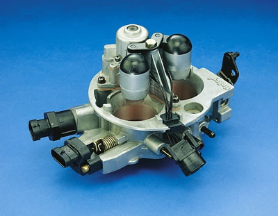

Posted March 17, 200420 yr comment_73087 I'm reading an article in one of the cruise magazines that we have here in Florida. The name of the article is "10 Engine Wives Tales Debunked". #2 Fuel injection always makes more power - Fuel injection does a great job when throttle position changes often. For types of racing where the throttle is wide open most of the time (i.e. drag racing), a carburetor is a formidable opponet - especially when matched against throttle body injection. I know what fuel injection is and I know where the throttle body is, but what is "Throttle Body Injection".Is that whats on the FI Z's?Vicky Link to comment https://www.classiczcars.com/forums/topic/10787-throttle-body-injection/ Share on other sites More sharing options...
March 17, 200420 yr comment_73088 Throttle body injection is what you see on older GM cars, where the throttle body looks almost like a carburator sitting on the intake, yet, it is not a carburator. Instead of having jets, etc.. they usually have 2-4 large injectors that dump the fuel into the intake runners. The air and fuel both are metered in the throttle body on a TBI system. The aftermarket Holley Pro-Jection systems are a TBI system, like this. Z's have a port injection system, where the injector shoots the fuel directly into the intake port on the head, with a separate injector controlling each cylinder, while the air mix is metered before the intake. Link to comment https://www.classiczcars.com/forums/topic/10787-throttle-body-injection/#findComment-73088 Share on other sites More sharing options...
March 17, 200420 yr Author comment_73100 Thanks 2ManyZs. Great explaination and super picture. I'm getting so smart................ Vicky Link to comment https://www.classiczcars.com/forums/topic/10787-throttle-body-injection/#findComment-73100 Share on other sites More sharing options...
