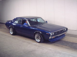

does anyone know how you would fit those wheel flares onto a 4 door, would cutting of the door panels etc be required? i saw a picture of an imported car which has them, ive attached the file.

Hey mate! Another one to strengthen our presence. I hope you have a good time here at the forums. Regarding the flares for a 4 door car, I think you'd just have to cut the flares up and attach to the door. A bit of fabrication work there... That's a guess though, I'd assume in Japan you can buy the flare set specifically made for a 4 door since there are a few with that done.

Also, where did you find that picture?

That, unless I'm mistaken looks like a picture from www.j-spec.com.au or alternatively the auction place where they get most their pictures from :)

The pic of the 4-door with flares seems to be from one of the Japanese auctions. Probably USS by the looks of the photo angle. They drive the cars through the photo booths at the auction and take front and rear shots while the car is momentarily stationary. These photos go on the website along with the auction grading sheet, and the same photos are used on screen when the car goes through the actual auction.

Llama,
Be careful about the Overfenders for the 4-door cars. They are shaped differently to the 2-door versions. You can indeed get two-piece Overfenders for the rear of the 4-door cars, and they are still being made by the aftermarket in Japan. You don't have to cut up the sheetmetal of the body unless you need clearance for wider wheels / tyres. This is not easy on the 4-door, as you have to cut the door and door opening if you want to go particularly wide ( don't do it! ). I've seen this done on a couple of cars in Japan and it looks like a real lot of work. My advice would be to fit the Overfenders if you want to, but don't get into the sheetmetal around the door opening.
No you would cut the flare, where the edge of the door is, unless they actually make 2 piece flares (SS -A9X LX Torana Style).
Edit (Alan says yes they do).
