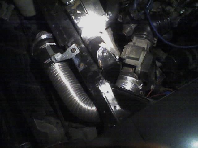

April 27, 200618 yr comment_165196 My PO did this with the intake. Seems to work just fine for me plus its flexable. You can buy all this at HOME DEPOT except the filter. It looks like crap but it works. I have a piece of 3" exhaust from a ford F250 that has a bend in it that I need to get bent about an inch tighter. It was free and in the back of the muffler shop. To heck with buying something that they just throw in the trash. Link to comment https://www.classiczcars.com/forums/topic/11132-custom-air-intake/?&page=2#findComment-165196 Share on other sites More sharing options...

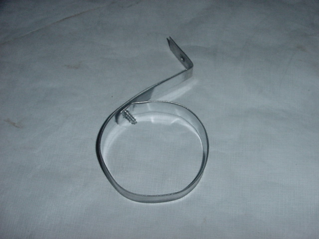

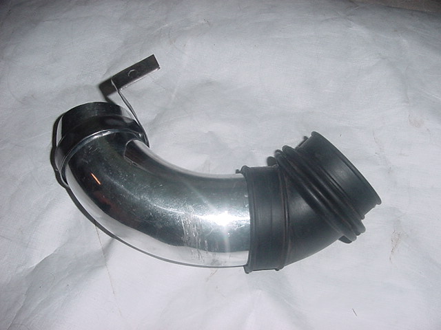

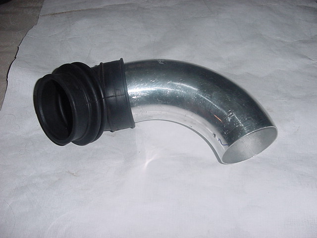

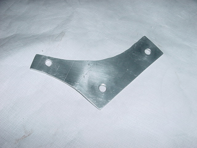

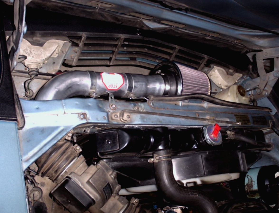

April 28, 200618 yr comment_165298 I finished making my intake! It uses an aluminum tube, and a cone filter I got off eBay . I used the oem rubber connector tube off the AFM(Pic #2&3), and I made an aluminum bracket (Pic #4) that bolts to the top of the radiator support where the airbox bolted ( to use up the bolt-holes) and a 'strap' made of chromed steel (from a square chair leg!)to hang the tube from the bracket(Pic #1). I wrapped the strap once around the tube for even pressure, and put three screws through the strap & tube. Link to comment https://www.classiczcars.com/forums/topic/11132-custom-air-intake/?&page=2#findComment-165298 Share on other sites More sharing options...

April 28, 200618 yr comment_165348 I finally have a bracket I like. It's 3/8" wide 1/8" thick aluminum flat stock with the mount end nicely rounded and smoothed. I don't like the sharp edges either. It polishes up just like the tube. I lke having the filter in the center where there is more room. I don't know how efficient any of our designs are. It's just for looks and any extra performance is a plus as far as I'm concerned. Link to comment https://www.classiczcars.com/forums/topic/11132-custom-air-intake/?&page=2#findComment-165348 Share on other sites More sharing options...

April 29, 200618 yr comment_165421 OK,I got the car out of the storage and I got the intake on the car. I started the engine with the hood up and checked the airflow. Putting my hand over the open end of the tube, I could feel all the air going by, and blocking the open end stalled the engine (obviously). So I put the cheapie cone filter on & I couldn't tell any difference in sound (cheap filter doesn't flow better than stock?). I put the hood down some, and revved the engine by hand. You actually could hear the deep racy sound! So I closed it all up and went for a drive. Maybe it does let the air through a little better, or maybe my AFM is messed up because of the improved air flow?One strange thing I noticed was that a bunch of water (I think) spit out of the tailppipe.Anyway, it's on, and it looks a better than the old oem airbox. Actually, about the only thing you can see is the bracket on the rad support and a little of the support strap. Link to comment https://www.classiczcars.com/forums/topic/11132-custom-air-intake/?&page=2#findComment-165421 Share on other sites More sharing options...
