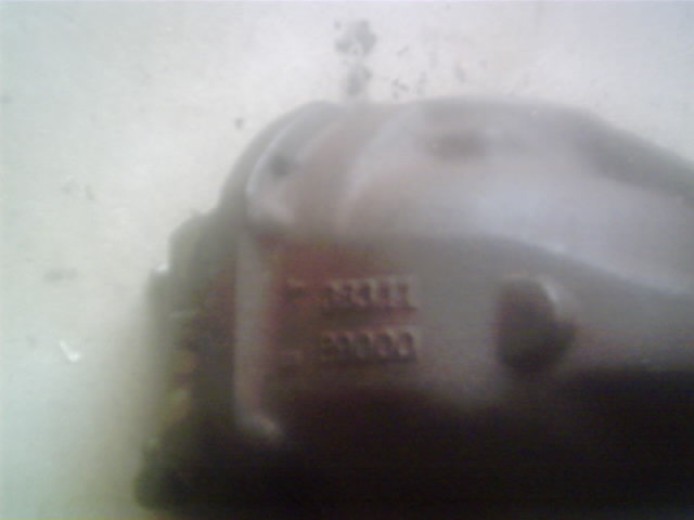

June 15, 200420 yr comment_85208 Here is a very bad photo of my diff. The # are as follows: A: 38311 B: P9000 I am just wouldering if I got hosed. The guy I got it form says it is a R200 diff. but I looked at a photo of the two and this one dosen't have the 5 bolt holes on the sides where the shafts go in. As I looked closer, I see a piece of metal going vertically inside where the shafts meet. Is this LSD? For my info. ( dont want to pull the diff. off of the car just to put the same on up) Thanks. I will post photos. (bad ones) Link to comment https://www.classiczcars.com/forums/topic/11133-r200-swap/?&page=2#findComment-85208 Share on other sites More sharing options...

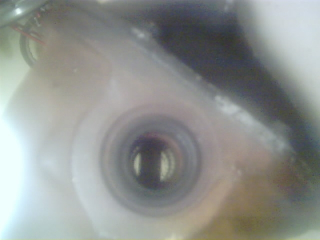

June 15, 200420 yr comment_85209 Here is the other shot looking through the hole. Notice no 5 bolt holes.:tapemouth Link to comment https://www.classiczcars.com/forums/topic/11133-r200-swap/?&page=2#findComment-85209 Share on other sites More sharing options...
June 16, 200420 yr Author comment_85227 It looks like the R 200 to me. Link to comment https://www.classiczcars.com/forums/topic/11133-r200-swap/?&page=2#findComment-85227 Share on other sites More sharing options...
June 16, 200420 yr Author comment_85228 The R180 has the 5 bolts where the shaft goes into it. Link to comment https://www.classiczcars.com/forums/topic/11133-r200-swap/?&page=2#findComment-85228 Share on other sites More sharing options...
June 16, 200420 yr comment_85238 So, I guess I just got the two mixed up. That is really good news. Thanks Ekustom. Link to comment https://www.classiczcars.com/forums/topic/11133-r200-swap/?&page=2#findComment-85238 Share on other sites More sharing options...

September 30, 200420 yr comment_97011 Dogma, I live in Florida where it is quite humid. My digital camera was in a 73 degree house and went to a 88 degree w/ 98% humidity ( or something like it) anyway, the camera fogged up. Kinda like when a person who has glasses walks from inside his house to outside where the weather is humid. Sorry. I'll erase them and post new ones for you. I'm not mad, I liked the joke. It does look like it's in a fish tank, though! By the way; does my diff have the LSD? Just woundering. Thanks Link to comment https://www.classiczcars.com/forums/topic/11133-r200-swap/?&page=2#findComment-97011 Share on other sites More sharing options...
September 30, 200420 yr comment_97031 The LSD assembly sits inside of the diff, you'd have to take off the backing plate, which is a good idea anyways....I took out my diff and put a new gasket with silicone on it to seal up some leaks, looks real good now. If there is just a ring and pinion gear, it's not LSD. If it looks any fancier, it could be LSD.Good luck on the conversion, and keep us informed! Link to comment https://www.classiczcars.com/forums/topic/11133-r200-swap/?&page=2#findComment-97031 Share on other sites More sharing options...
