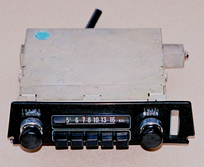

April 10, 200420 yr comment_76356 This is an early radio and face plate. Hitachi AM with touch tuning. The antenna rocker switch goes on the side. This was probably standard up to mid '70? Or early '71? Link to comment https://www.classiczcars.com/forums/topic/11179-radio-question/#findComment-76356 Share on other sites More sharing options...

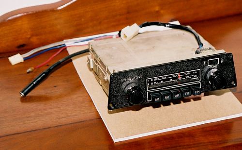

April 10, 200420 yr comment_76357 And this Hitachi AM / FM with the antenna toggle switch above appeared with the '72 model year cars. Link to comment https://www.classiczcars.com/forums/topic/11179-radio-question/#findComment-76357 Share on other sites More sharing options...
April 10, 200420 yr Author comment_76406 Thanks 26th Z for the pictures it's much appreciated, However I would be grateful if you could take a look at the attached, Enrique has advised that the earliest radio's were AM only and had the toggle switch to the side, as you will see this unit has FM clearly marked on the buttons but has the switch to the side. Can you advise which model year this may have come from. Thank again Lee Link to comment https://www.classiczcars.com/forums/topic/11179-radio-question/#findComment-76406 Share on other sites More sharing options...
April 10, 200420 yr comment_76409 Lee, that looks like the ones that came in the 260's if I'm not mistaken. Looks like the one that I took out of my 75 280 many years ago. I think that it may have been the standard radio in the 74-78 cars. Link to comment https://www.classiczcars.com/forums/topic/11179-radio-question/#findComment-76409 Share on other sites More sharing options...
April 11, 200420 yr comment_76410 Originally posted by 2ManyZs Lee, that looks like the ones that came in the 260's if I'm not mistaken. Looks like the one that I took out of my 75 280 many years ago. I think that it may have been the standard radio in the 74-78 cars. Yes, that actually looks like the one in my '78 280Z as well. It's interested me that they put the antenna rocker back on the right side. So, my '70 240Z and my '78 280Z have the same antenna rocker position. The 280 is AM/FM and the 240 is AM only. Link to comment https://www.classiczcars.com/forums/topic/11179-radio-question/#findComment-76410 Share on other sites More sharing options...
April 11, 200420 yr comment_76411 Lee:If you look at the faceplate with the radio you posted, you'll note that the sides angle outwards from bottom to top. The 240's had it angled very slightly INWARDS from bottom to top. Even if you were to turn your faceplate upside down, it would still be too wide and have too steep an angle to fit in the Heater Control Panel.Additionally, the early 240 radios when they finally added FM, only had TWO buttons to switch to FM, not three as your picture shows, and they were on the right hand side of the set of five.The additional clues that point to your picture being of a later model Z, or another car, is that there are no screw holes in the lower edge corners, and there is additional silver trim on your faceplate. The earlier radio faceplates needed the screws to lock onto the HCP and had very little decoration (only the names of the knobs and the antenna directions on the switch above, and the antenna directions on the toggle knob on the up and down on the side.)Hope this helps.Enrique Scanlon Link to comment https://www.classiczcars.com/forums/topic/11179-radio-question/#findComment-76411 Share on other sites More sharing options...
April 11, 200420 yr Author comment_76442 Thanks for the great info guy's, your advice will help me a lot in my search for an original 1970 radio (now I know exactly what I'm looking for.Particular thanks to Enrique for the in depth response and for pointing out the face plate configuration, had'nt even noticed that.ThanksLee Link to comment https://www.classiczcars.com/forums/topic/11179-radio-question/#findComment-76442 Share on other sites More sharing options...
