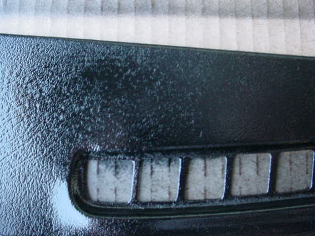

Anybody have any suggestions on how to refinish the metal panel on the dash that covers the defroster outlets. The one on my 72 is kind of grungy and no amount of scrubbing seems to help it. It seems to be textured below the black surface. I wonder if anybody has repainted theirs?
Thanks in advance.
Chris

When I redid my interior, I scrubbed that piece with some soap and water, then scuffed it with a scotch pad and shot Rustoleum Satin Black on it. It looks great.
Don't recall the texture you describe, will have to check on that.
Texture can be a matter of painting technique or paint. The texture you seek is what defines it. There are wrinkle paints, which give a look and texture similar to shattered safety glass. Then there is the spackle effect. That one is created by doing a heavy MIST and allowing to tack dry before additional coats are applied.
Hope this helps.
Enrique

Thanks Enrique for the tips, I just got done lightly scuffing it with a Scotchbrite pad and it looks like the texture is in the metal somehow. I got down to some shiny metal underneath and the texture is still there. I shot it black, not too bad now. Here's a picture.
Chris
