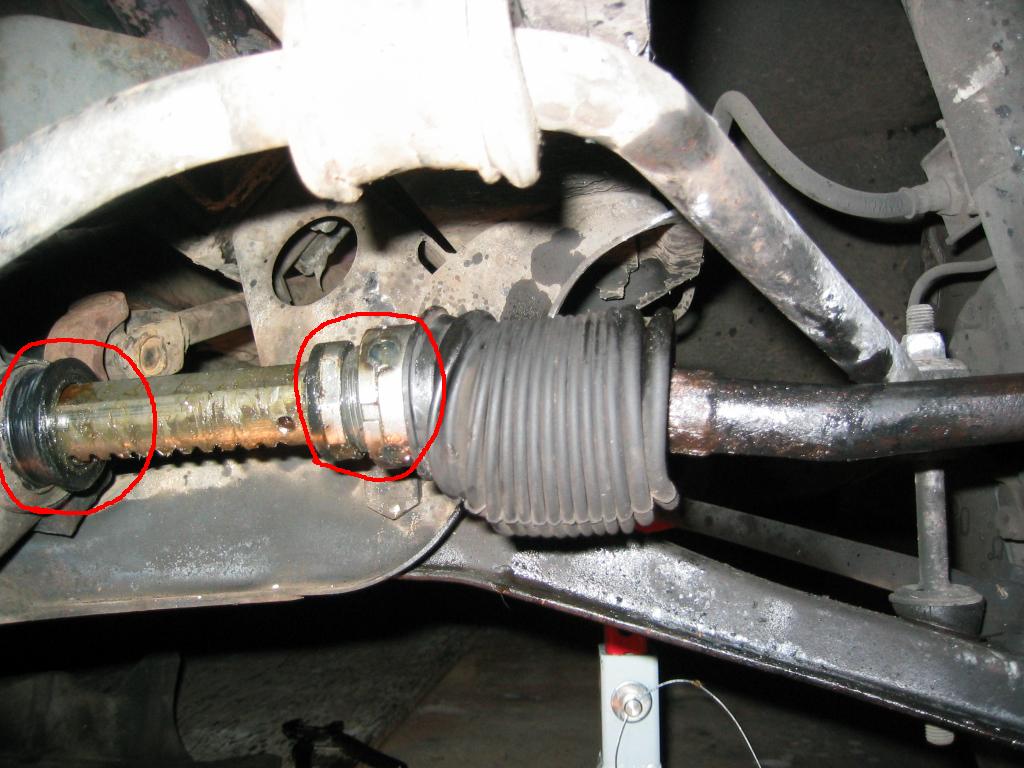

that is your stearing rack and you can't take that apart with out a serious pain in the butt. I would consentrate on that Nut! What was wrong with the tie rod? Man, there's nothing worse than rusted nutsROFL .

ok, well i cant get the nut off unless i torch it, the only way to torch it is to take it to school, so i have to remove something to get it to school tomorrow morning
btw the alignment is off, and steering wheel is off, and the nut is rusted so tight that it cant be aligned
Is there no way to remove one of these parts? the one on the right of the attached picture is threaded and looks in good condition i.e. its not rusted so it looks like it could be removed if not i need to find some way to get this thing to school tomorrow
S snake, you don't need to (nor do you want to) take apart the item circled on your picture. It won't allow you to just replace the part you want (you'll end up taking another car apart to replace what you want now).
Slide the rubber boot towards the center of the car. You will see two wrench flats on inner tie rod end..
Look at the direction of the exposed threads........ They should be LEFT-HANDED. Turn the jam nut as though you were tightening a standard R-H nut.
Should come apart if you haven't tightened it so much already.

The tie rod end is the cast looking thing that has the ball joint in it. At the inside end of it (Which is hidden under your dust boot in the picture) there is a flat on the tie rod end and a lock nut. You have to twist them in opposite directions to get the tie rod end loose.
