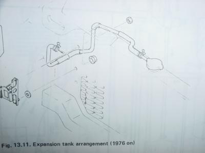

April 21, 200420 yr comment_78087 I think there are some holes on the pass. side, front of the radiator support, to mount the tank. I wouldn't want it on the driver's side, either. The air cleaner is there & I wouldn't want to suck in any coolant. See attaced pic. Link to comment https://www.classiczcars.com/forums/topic/11367-coolant-overflow/#findComment-78087 Share on other sites More sharing options...
April 21, 200420 yr Author comment_78109 I went by the dealer today, and they said that they do not show a part number until '76 models. I can see where it looks like a place for one where you guys described. I picked up a universal one from Pepgirls today, but have not tried to mount it just yet. Link to comment https://www.classiczcars.com/forums/topic/11367-coolant-overflow/#findComment-78109 Share on other sites More sharing options...
