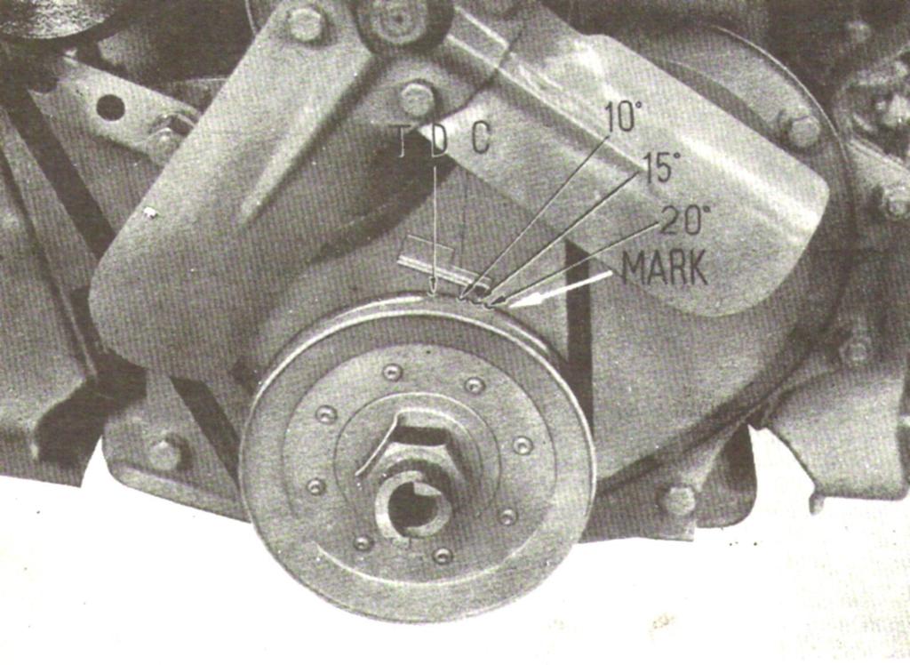

Posted April 25, 200420 yr comment_78492 this isnt really a z car question but its a datsun question, does anyone know the fireing order for an old datsun 1.3 liter. and how to tell if the damn thing is at TDC, I cant see a balancer or anything like that. Just curious since Im not used to working on 4-bangers. Link to comment https://www.classiczcars.com/forums/topic/11426-need-help/ Share on other sites More sharing options...
April 25, 200420 yr comment_78498 I'm not familiar with a 1.3 liter Datsun engine but if it's the same as other 4 cylinder Datsun engines (L18, L20, etc.) it's 1-3-4-2 Link to comment https://www.classiczcars.com/forums/topic/11426-need-help/#findComment-78498 Share on other sites More sharing options...
April 25, 200420 yr comment_78500 If youre talking about a J13 look at this: Link to comment https://www.classiczcars.com/forums/topic/11426-need-help/#findComment-78500 Share on other sites More sharing options...
