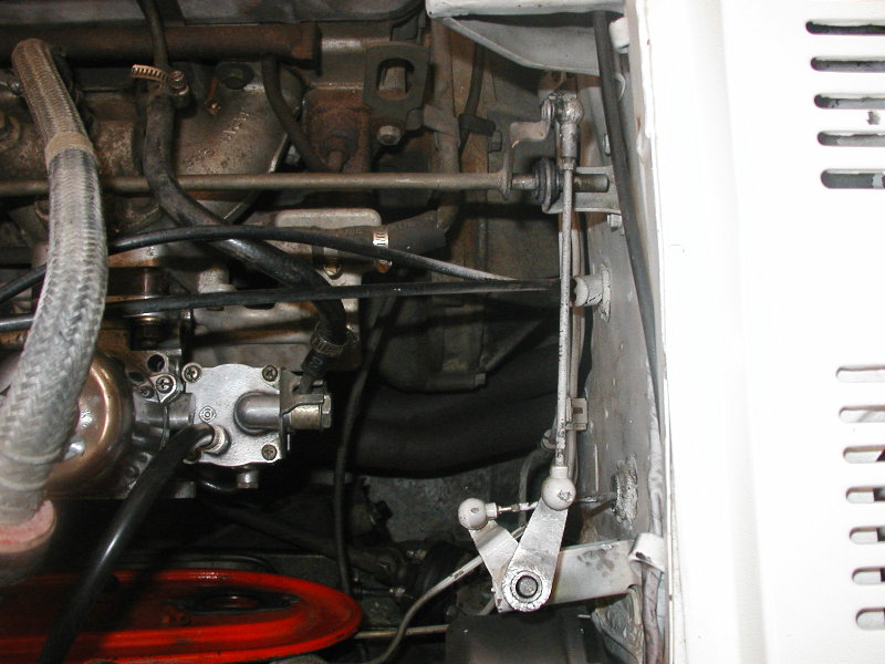

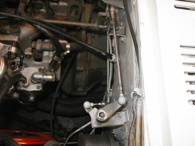

I could not stand the "sticky agressive" throttle any more. It is where you start to give it gas and it kind of sticks and then gives, making it hard to get a smooth start. After reading all the posts this appears to be a common problem on the early Z's and I could not find any pictures except for the tech article on ZHOME.COM

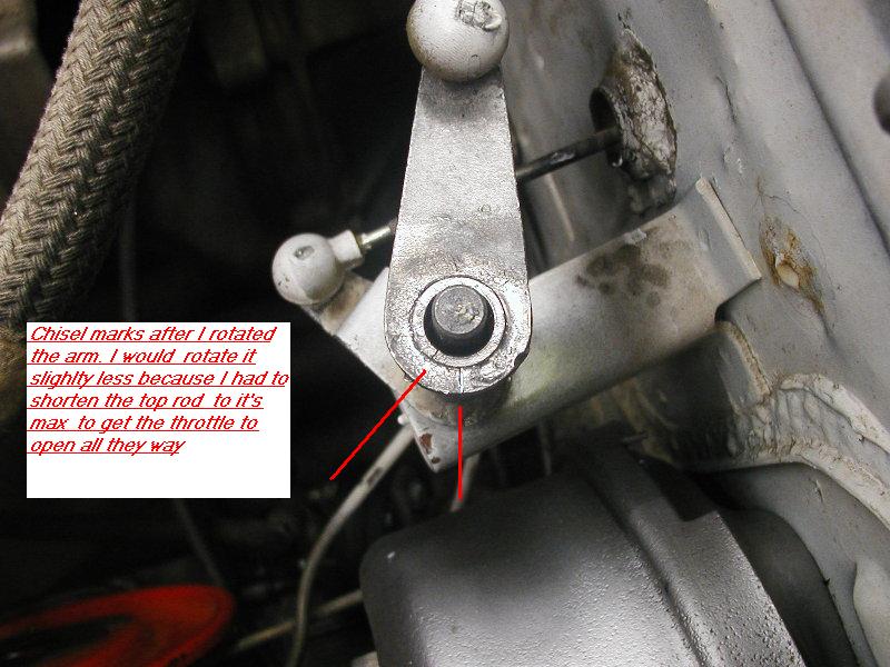

I decided to take off the "arm" grind off the weld and reposition it to see if I could get it to smooth out.
As you can see in the pictures it did not take much of a turn, in fact I would turn it a bit LESS because I had to shorten the top rod almost to it's max and unscrew in the accelerator rod a 1/4" to get the throttle to open all the way.
The reason I didn't repostition it again is because I really welded it up to much and didn't want to grind it off again and I thought I could adjust it more with the rods.
I can say for sure that it worked fantastic. The whole day I drove around I kept expecting the "stick then give" but it is as smooth as a new car. I can start at idle and slowly bring it up to any rpm.
Also if you have a new throttle boot this is the time to replace it. My neck is still out of joint!

Just be careful that at full throttle opening the belcrank is still moving towards the carb throttle linkage!!!! If not, the harder you push your throttle pedal you'll actually start closing the carbs down.
I suppose you could adjust the pedal stop so that this wont happen.
