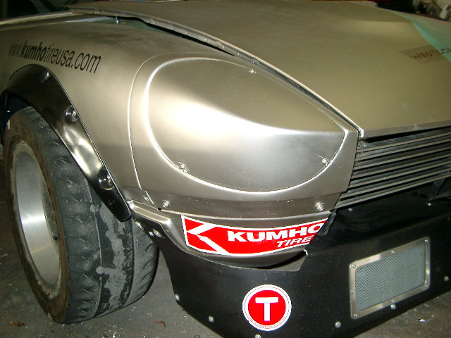

Don't bother, they won't fit.
The genuine Nissan option headlamp covers actually overlap the headlamp pod / sugar scoop / extension. The acrylic is shaped such that it would sit on the outside of the pod, even if there was no chrome ( later stainless ) surround garnish. The garnish actually sandwiches the acrylic onto the pod.
As far as I am aware - from the aftermarket covers I have seen - the aftermarket acrylic sits flush with the pod ( kind of IN the pod, if you will ) so its actually smaller than the acrylic in the Nissan option covers.
Essentially they are - therefore - slightly different shapes too.
Here is a picture of the MSA covers--installed without the rubber gasket supplied--and painted, so you can REALLY see the profile better than clear and how much smaller it is than the opening. These things are absolute junk. This is a shattered (yes they do that if you look at them wrong), salvaged set that I caulked in and painted for cheap race car use. Perfect use!
