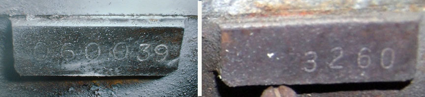

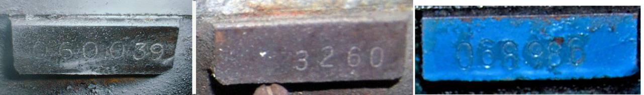

October 2, 201014 yr comment_332329 Since the "6" and "0" aren't the same font... I'd say the block was not stamped at the Factory L24-3260 9901A 12/69 HLS30 00587 FWIW, Carl B. Link to comment https://www.classiczcars.com/forums/topic/11743-1970-engine/?&page=7#findComment-332329 Share on other sites More sharing options...
October 3, 201014 yr Author comment_332363 Carl, Thank you, I believe you have solved the mystery. As you stated in post #71 and what I had speculated in post #32, it was a replacement engine that was most likely stamped by the dealer. Link to comment https://www.classiczcars.com/forums/topic/11743-1970-engine/?&page=7#findComment-332363 Share on other sites More sharing options...
October 3, 201014 yr comment_332391 I just noticed that the first 7 engine numbers in Carl's list do not have a '00' in front of the numbers like 004621. Photos in post 7 & 73 show this. I went to the garage 3 times to verify the double 0's before posting. The 2 exceptions would be ol'red70 and abas. Was this done to prevent forgery? Another mystery?Bonzi Lon Link to comment https://www.classiczcars.com/forums/topic/11743-1970-engine/?&page=7#findComment-332391 Share on other sites More sharing options...

October 4, 201014 yr comment_332531 Thank you Car, you pointed out the Font, yes they are different. Not in the Yokohama factory, it would have happened in the dealer,I see. In that case,vice versa could happen, i.e. a 1969 car could have a later block with P30 or what ever with engine serial number L24-002### with different Font. Yes. If the engine was replaced with a Factory New short block - the Dealer would have stamped a serial number on that block - usually with a different set of dies, that had a different font style. And in that case, how about fitting with a head, are they (E31 head with P30 block or E88 head with E31 block) docking each other without any problem? The Factory supplied Complete New L24 engines and they also supplied New L24 "short blocks". That would be an engine without a new head and without new exterior items like oil pump, water pump, front timing cover, etc. If a short block was needed/used the additional parts from the original engine were put on the new short block. Yes all exterior parts from either the E31 or P30 were interchangable. I have heard my friend saw a Z432 it has an engine without engine serial number.The owner told my friend not for sure but maybe the engine was replaced some time ago. I would guess that would be quite possible. Here is a picture of the serial numbers stamped by the factory in a late 71 production 240Z. You can see that the factory font is the same as the earlier factory font. {the shape of the "0" and "6"} FWIW, Carl B. Link to comment https://www.classiczcars.com/forums/topic/11743-1970-engine/?&page=7#findComment-332531 Share on other sites More sharing options...
