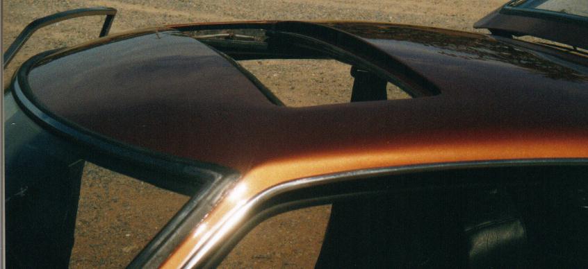

April 4, 200520 yr comment_119390 Hi Rick,I have also been searching for ANYTHING related to a Coenen sunroof for a while, which I have in a '73 240Z I bought in SA 18 months ago. Photo is attached...does yours look like this? Usual problems with it (leaks in heavy rain and whenever i wash the car), but I've managed to solve most problems by installing some decent drainage using std water reticulation hosing parts you get from the garden shop! Have decided to keep it as the car is fairly neat and rust free in the roof, and the previous owner reckoned it was installed as a dealer option in 73..Did you manage to get hold of the original manufacturer in Germany?Mark Link to comment https://www.classiczcars.com/forums/topic/11981-suggestions-anyone/#findComment-119390 Share on other sites More sharing options...
April 4, 200520 yr comment_119391 Woops...forgot to add the Coenen sunroof photo to the last post. Mark Link to comment https://www.classiczcars.com/forums/topic/11981-suggestions-anyone/#findComment-119391 Share on other sites More sharing options...
April 4, 200520 yr Author comment_119401 G'Day Mark, I'm in total sympathy with you mate. No doubt you've read the posts from Seerex. I followed them up without any luck whatsoever. I've been in contact with Jag clubs in Australia and England, (2 Pom clubs didn't even bother to reply), all without luck. To the best of my knowledge, Coenen is no longer in production, which is not surprising after 30 odd years. The best I've been able to come up with is what I'd call "Piping", normally seen around the edges of a seat. Not a perfect seal but it keeps out most of the water and the drains take care of what slips past. I've tried several different weather seals and the "Piping" is the best so far. I'm the second owner of "Precious" and was fortunate to find a contact address of the original owner in the glove box, so I was able to get answers to several questions, one being the origin of the sunroof. Your info is correct, it was a dealer option. Bloody sunroof gives me a headache on a bumpy road though. I spoke to a panel beater friend about the feasability of having the sunroof removed and was told it would be cheaper to replace the entire roof so that idea went out the window. Sorry I can't be of more help to you. Regards, Rick. Link to comment https://www.classiczcars.com/forums/topic/11981-suggestions-anyone/#findComment-119401 Share on other sites More sharing options...

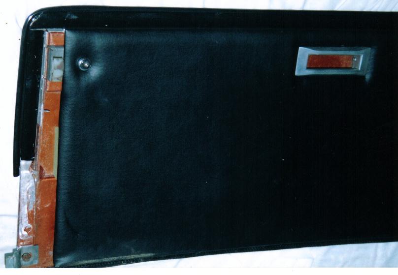

April 5, 200520 yr comment_119494 G'Day Rick,Great minds think alike mate! I also use a type of piping in the sealing of the sunroof. It's a "C" section neoprene extrusion which I bought from a Sydney Coy called "Grippy Rubber Products" (specialist manufacturers in early model auto rubbers in Syd). I "clip" the section into the roof hole (NB: piping not shown in the photo) and used a neoprene contact cement for sealing SCUBA wetsuits to join the ends. On the sliding roof section I bonded felt to the rubber sealing gasket, which reduces the rubber-rubber friction problems when opening/closing. Grippy told me the non-UV stalised rubber will probably degrade over time, but I've got no idea how long, as I've had to replace it already (on the freeway coming back from the Z Car Nationals in Goulburn over Easter I had to close the sunroof, and the seal flew off !) If you want photos of my design, I can email them to you.BTW, I notice your Z seems to have the original vinyl trim on the sunroof. Mine has dodgy material and have booked her in to have a custom vinyl headliner made up. If you "Precious" has original headliner perhaps you could email me some shots of how the dealer sovled trim details in areas around the rear drain pipes, sunvisor mounts etc! In exchange would be happy to send a copy of the 1950 Coenen patent (in English) I downloaded! Not real helpful, but the diagrams are interesting.CheersMark Link to comment https://www.classiczcars.com/forums/topic/11981-suggestions-anyone/#findComment-119494 Share on other sites More sharing options...

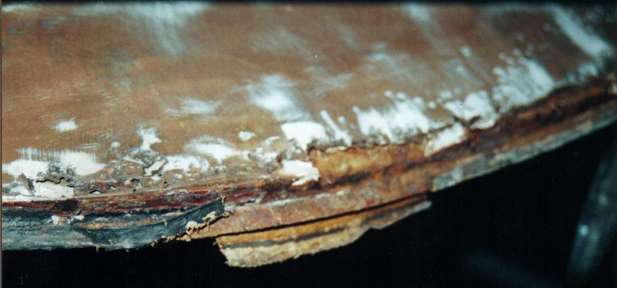

April 5, 200520 yr Author comment_119517 G'Day Mark, No, mate, that vinyl aint original. With the exception of the seats and hood lining, professionaly done, my wife and I have replaced all other vinyl. Original vinyl was tan in colour but, as it needed replacing anyway, I decided I'd prefer black. The plastic panels in the hatch I cleaned with vinegar, then a good rub down with metho followed by three coats of black vinyl spray paint. Any reasonably proficient motor trimmer shouldn't have any trouble with installing a new headlining. I'll check through my photos and see if there are any that might help. If you're having a new headlining put in, when the windscreen comes out, be prepared for a possible shock. You can imagine my surprise. I was fortunate to find a bloke who took pride in his work. Before painting, it was hard to see where he had welded in the new section. Rick. Link to comment https://www.classiczcars.com/forums/topic/11981-suggestions-anyone/#findComment-119517 Share on other sites More sharing options...
