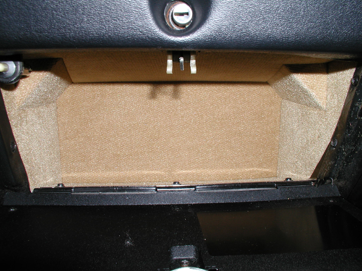

I used my old old box and carefully remove the staples, traced the parts onto some heavy duty poster board and cut them out with a razor knife. I scored the back side at each location where there would be a bend so that it would be clean and sharp. Then I covered the inside with the same fabric that I used on my seats. It's not stock but it looks kinda cool. I chose to glue the pieces together for a cleaner look rather than use staples or rivets. BTW, I had to remove the heater fan/box and right side defroster vent tube to get my box out and then back in.
Photo of finished glove box.
