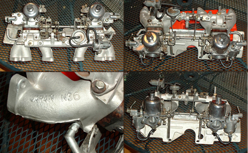

September 3, 200420 yr comment_93655 Is the manifold from the 1973 240Z the same as the one in the 260Z w/ the flattop carbs? If so, won't he need to use the thinner spacers because the studs on the 260Z manifold are shorter, or do like I'm doing and swap the studs from the early 240Z manifold? I tried my early carbs with the shorter studs, but just barely got the nuts threaded on. Bought some of the thinner spacers, but decided to just swap studs and use my old thicker spacers. I'll post a couple pics with the carbs mounted on the N36 Intake from a 260Z to show how the nuts barely thread on to the shorter studs. Anyway, if the 73 manifold has the longer studs my question is moot. Gary Link to comment https://www.classiczcars.com/forums/topic/12159-installation-of-round-tops-in-a-73-240/?&page=2#findComment-93655 Share on other sites More sharing options...
