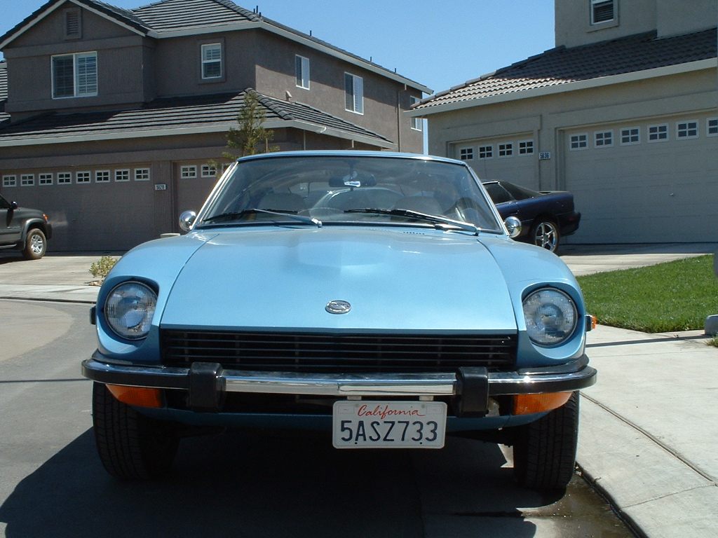

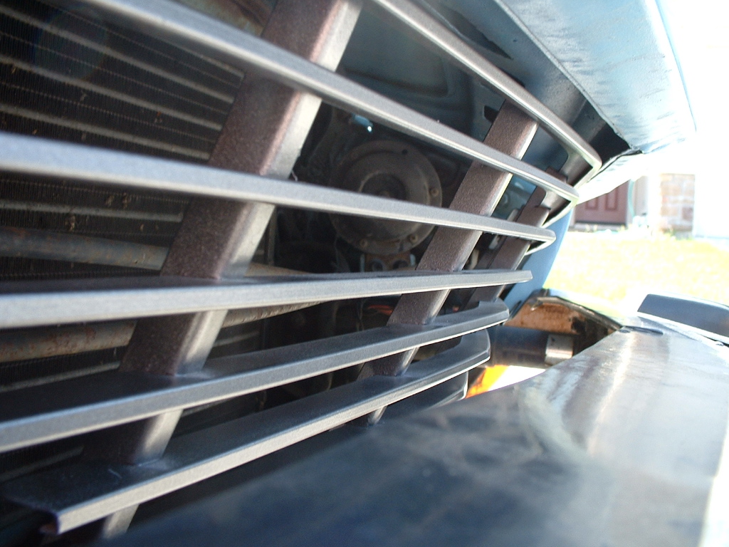

I just painted finished painting my grill last night. I started with a Rust Tough primer after sanding with 600 grit/wet. Then I sanded the thick coat of primer with 600 wet again. Color was added, and I used the Dupli-Color Graphite WP102, and then the Rust-oleum 1902 matte clear. Here is the first picture. I should have taken the photos of the grill before it was installed, but after it was dry I was too excited. I had to put it on. I am really happy with the color and finish.
Ben
This looks so much better than my rusted, paint splotched grill.
Ben:classic:
p.s. I am going to wash her tomorrow because she is very dusty as everyone can probably tell.

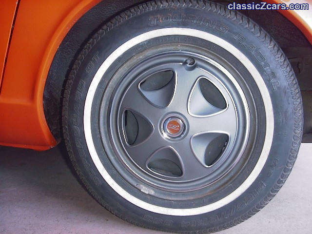

Hi Ben,
I finished my first 2 trial run 1 with the WP 102, WP 103 and the matte and the 2nd with 102 and and just the matte. I'll post pics tommorrow when I have better light and camara. I not sure which one is a closer match. Any pictures available of original hub caps?
