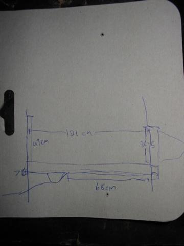

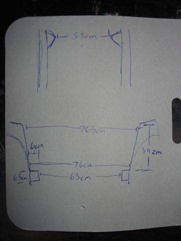

I've been asked this question before, so one day I measured my empty engine bay and jotted the measuremets down on the back of a piece of card.
here they are
