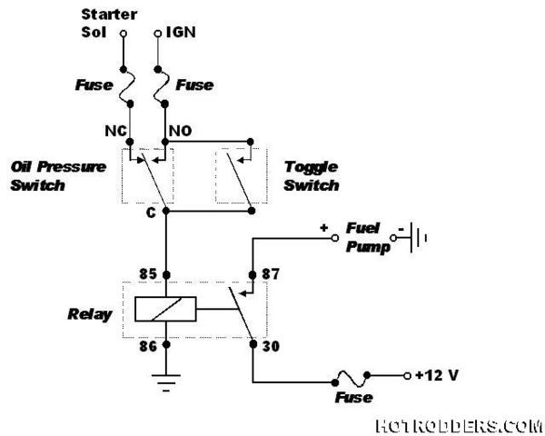

June 24, 200420 yr comment_86307 This is great information, Mike. Thanks for posting it! Information like this gets me (and others) much further down the road on this type of project. Thanks for taking the time to put it all together and post it.:classic: I noticed that Holley doesn't show a relay in the circuit to power the Fuel pump, does anyone know how to modify the circuit shown in the schematic to incorporate a relay to protect our fragile 30 year old wiring? Link to comment https://www.classiczcars.com/forums/topic/12302-mazda-rx-7-fuel-pump/?&page=2#findComment-86307 Share on other sites More sharing options...
June 24, 200420 yr comment_86339 Originally posted by Bambikiller240 ......relay in the circuit to power the Fuel pump, does anyone know how to modify the circuit shown in the schematic to incorporate a relay to protect our fragile 30 year old wiring? How about this? Chris Link to comment https://www.classiczcars.com/forums/topic/12302-mazda-rx-7-fuel-pump/?&page=2#findComment-86339 Share on other sites More sharing options...

June 24, 200420 yr comment_86423 Well I'm at a loss as to HOW you all expect to "prime" the fuel bowls when the pump will not function unless the motor is running?Possibly, a by pass circuit the powers up the fuel pump when the motor isn't running?Forget the fancy options and just go with the pump with the in-built safety. Link to comment https://www.classiczcars.com/forums/topic/12302-mazda-rx-7-fuel-pump/?&page=2#findComment-86423 Share on other sites More sharing options...
