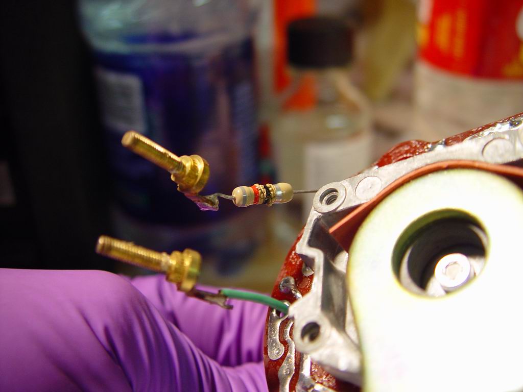

I ended up buying a tach from a 280Z and swapping the internals into my 240Z, although I haven't gotten that to work yet (it sort of worked, went to around the right RPMs but it bounced around a lot, even with the correct resistor inline on the negative trip). I think the problem may be a bad ground on the molex plug going into the back of the tach wiring. Some other more urgent stuff came up, and I need to fix that before I can get the tach problems sorted out.
One thing to note about my 240Z tach was I noticed a certain resistor(see attached pic) seemed to have some heat damage, I think I remember reading about some people replacing this resistor and having their problems gone away as a result. I would have tried this, except for the fact that I shattered the PCB in the back of my original tach popping it free from the epoxy stuff holding it into the housing
