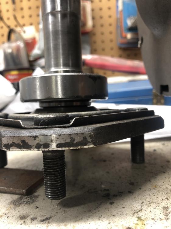

May 4, 20195 yr comment_574847 Well we put the new axle and bearing into the hub and everything is great! It was likely a bearing issue at this point, but I haven't had a chance to rule out the stub. There is a tiny gap that you can see light through on the bad stub between the collar of the bearing and the seating surface. I can barely get my thinnest feeler gauge through it which is 0.0016. I think it just never got fully seated. It doesn't explain why it was binding in the same spot when rotated though. I'm gonna pull the bearing off for the 5th time now and really inspect that surface to see if I can figure it out.At least I have an extra set of hubs and bearings just in case now ? Thanks again for all the help and advice! Edited May 4, 20195 yr by the_unknown Link to comment https://www.classiczcars.com/forums/topic/12577-replacing-s30-rear-wheel-bearings/?&page=8#findComment-574847 Share on other sites More sharing options...
May 5, 20195 yr comment_574858 I'm glad the story was that boring! Although a harrowing hair raising saga would have been much more entertaining! And I'm also glad that you've got a set of hubs put together now that are issue-free. And if you've got a gap between the flange and the outboard bearing, that's definitely a raging clue as to the previous issue. 1.6 thousandths can be a LOT when talking about bearings. Just for forensic analysis... See if you can determine if that gap is the same all the way around the bearing. If it's the same all the way around, in theory it shouldn't cause what you saw. But if it's .0016 on one side and zero on the other (which is what I suspect), then it's indicative that something is bent or you got some piece of grit or metal shaving trapped under the bearing race. In any event, it's almost definitely related to the problem. Link to comment https://www.classiczcars.com/forums/topic/12577-replacing-s30-rear-wheel-bearings/?&page=8#findComment-574858 Share on other sites More sharing options...
May 5, 20195 yr comment_574871 This is the gap. It is even on all sides which would make sense. I'd imagine it would be difficult to get it that far onto the seating surface if it was ****-eyed. I'm thinking the distance piece at this point was too long and binding the balls against the outer races. I pulled the bearing off last night and everything seemed ok. Nothing there that it should have bound on. I'm just glad I got to drive it some after it's been sitting on blocks for nearly a month. The only "exciting" part of the story was coming back through Morgantown WV on I68 in the pouring rain and having the clutch slip going up the mountain passes. It got a little nerve wracking but I knew I was almost home and could easily get a tow at that point. I've still got some work to do to her but the suspension and brakes are basically done now. I still need to powdercoat the mustache bar but the big oven at my local makerspace isn't quite ready yet. Edited May 5, 20195 yr by the_unknown Link to comment https://www.classiczcars.com/forums/topic/12577-replacing-s30-rear-wheel-bearings/?&page=8#findComment-574871 Share on other sites More sharing options...

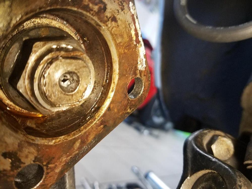

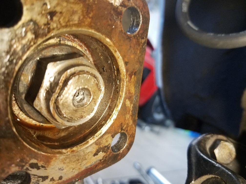

May 22, 20195 yr comment_575953 Hi All, So the only way to remove the rear wheel bearing locknuts is cut off the top pinched section? What a cluster! One time use parts? Link to comment https://www.classiczcars.com/forums/topic/12577-replacing-s30-rear-wheel-bearings/?&page=8#findComment-575953 Share on other sites More sharing options...
May 22, 20195 yr comment_575956 Yes. The original ones are one use parts. After you do the hubs once, you won't really want to do it again. Besides it's been 45 years on the first ones! The 280zx nut is a self locking nut and could possible be used again. Although a lot of people advise against. So buyer beware! Link to comment https://www.classiczcars.com/forums/topic/12577-replacing-s30-rear-wheel-bearings/?&page=8#findComment-575956 Share on other sites More sharing options...
May 22, 20195 yr comment_575984 I first used a dremel tool to cut away the peened/staked part of the nut, but having changed many wheel bearings since, I just get a very small cold chisel and wedge it between the bolt and the nut to push the deformed part outward. Works great. Tip... use a grinder to keep the cold chisel tip in good form. Link to comment https://www.classiczcars.com/forums/topic/12577-replacing-s30-rear-wheel-bearings/?&page=8#findComment-575984 Share on other sites More sharing options...
May 22, 20195 yr comment_575986 I am surprised the peened part even needs to be addressed. With a larger breaker I would have guessed it just pushes out of the way. I assumed it was there to keep the nut from loosening from vibration, not the blunt force of a breaker bar. Link to comment https://www.classiczcars.com/forums/topic/12577-replacing-s30-rear-wheel-bearings/?&page=8#findComment-575986 Share on other sites More sharing options...
