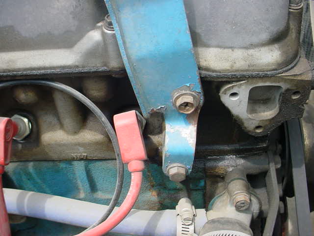

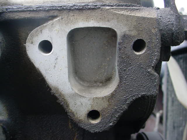

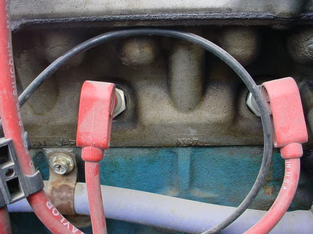

August 5, 200420 yr comment_89952 Hey 240ZX, here's some pics of my N47 with the fuel pump hole not drilled out for the pump. Interesting that the holes are drilled and tapped but the pump arm hole isnt. Chris Link to comment https://www.classiczcars.com/forums/topic/12765-what-should-i-replace-while-the-engine-is-out/#findComment-89952 Share on other sites More sharing options...
August 5, 200420 yr comment_89953 Hey 240ZX, here's some pics of my N47 with the fuel pump hole not drilled out for the pump. Interesting that the holes are drilled and tapped but the pump arm hole isnt. Chris Just get a Dremel and fix that problem!! Link to comment https://www.classiczcars.com/forums/topic/12765-what-should-i-replace-while-the-engine-is-out/#findComment-89953 Share on other sites More sharing options...
August 5, 200420 yr comment_89955 Just get a Dremel and fix that problem!! I actually thought of that but I didnt want to pull the head off to clean out all the alloy bits. Stuff it and run it!!! Chris Link to comment https://www.classiczcars.com/forums/topic/12765-what-should-i-replace-while-the-engine-is-out/#findComment-89955 Share on other sites More sharing options...
