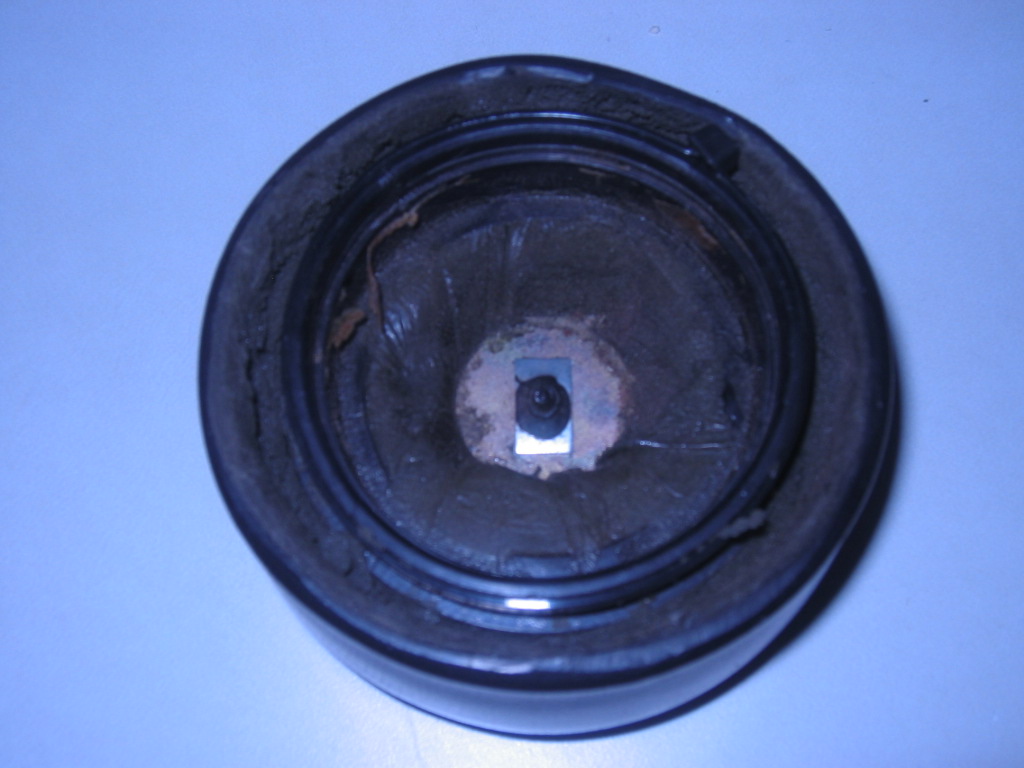

When I bought my '73 240Z, most of the interior parts had been removed and were piled in the rear. After I painted the car I put the interior back together, and I noticed that the horn button would fall off at the slightest touch, even though it seemed to snap into place. Closer inspection revealed a crack in the inner plastic "ring", the one with a groove that is supposed to snap onto the steering wheel, as shown in the first photo.

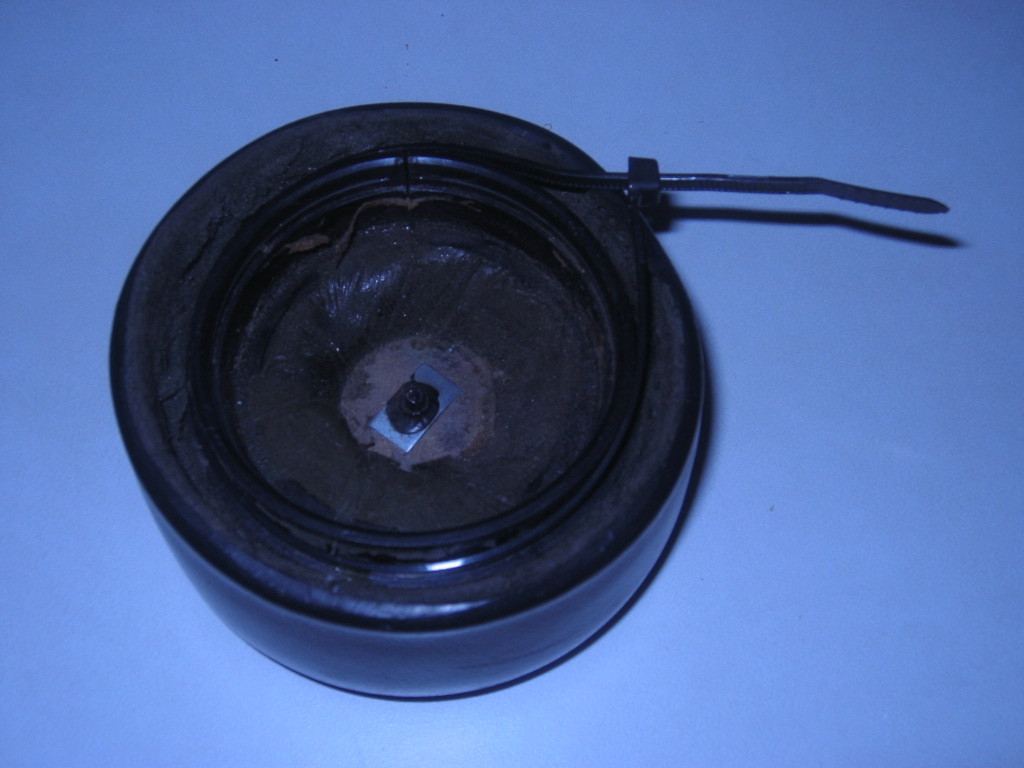

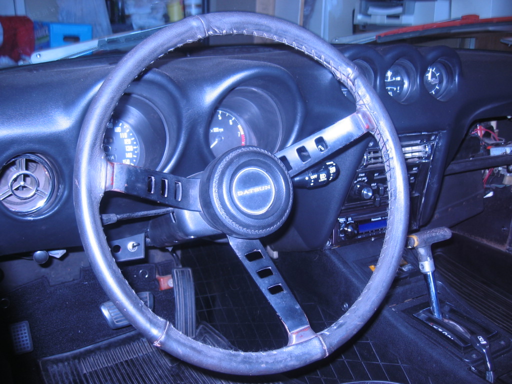

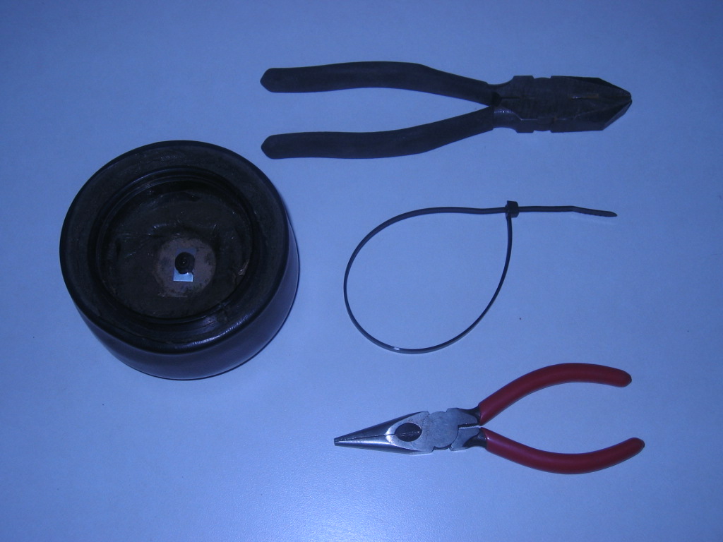

After scratching the old noodle for awhile, and being a DIY type of guy, I came up with a simple fix: it seemed that a tie-wrap cinched around the outer perimeter of the plastic ring would make the horn button stay in place. The second photo shows the horn button, tie-wrap, and a couple of pliers I used to do the job...the 3rd photo shows the tie-wrap in place, before it was cinched tight, that's where the pliers came in handy. The 4th photo shows the tie-wrap in place and trimmed up. Finally, the last photo shows the horn button SECURELY installed on the steering wheel...it hasn't come off since!
