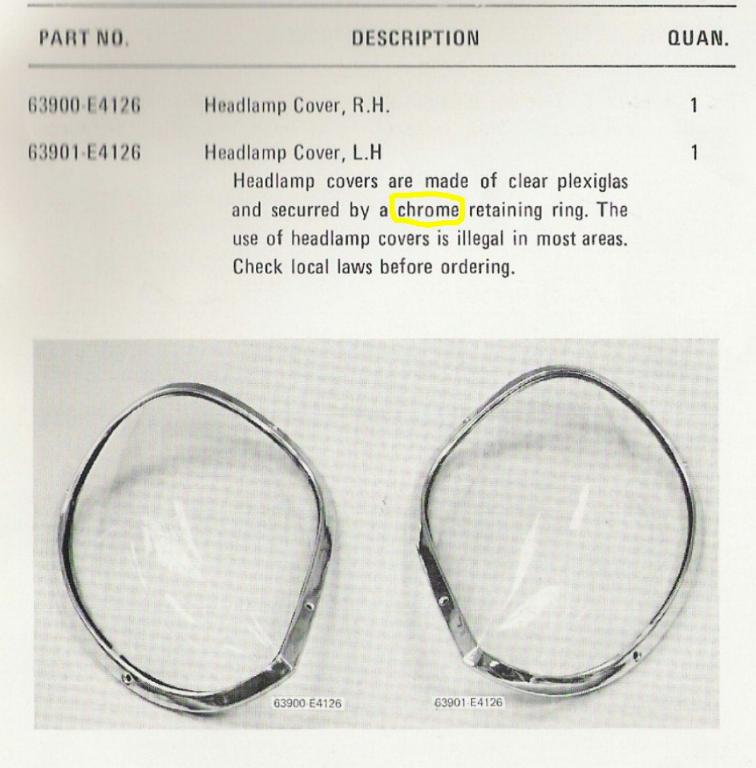

The mounting screws go through both the chrome ring and the plexi. The plexi extends to 1/16" of the outer edge of the chrome ring all the way around. That is to say the outer edge of the plexi is a smooth curve, as the the inner and outer edges of the chrome ring. The ring is about 3/4" wide and completely uniform. I tried to post pictures on thursday, but it appears my card reader has bitten the dust. Follow the link from BlueZ to a decent picture of them-I will try to replace my card reader over the next day or so.

Hi everyone
I think I have an idea of what they look like now. Thanks for posting the pictures.
I am now wondering if they where stamped from a sheet, or a solid casting. They look like they where stamped.
I would also like to know what the brackets looked like.
Thanks Ahmed.
Ahmed,
Check my gallery, I posted pictures of all of the parts last night. The chrome trim is made up of two stamped pieces welded together(I photographed it from the bottom so the welds were in view. The Plexi was proably molded from a flat sheet.
